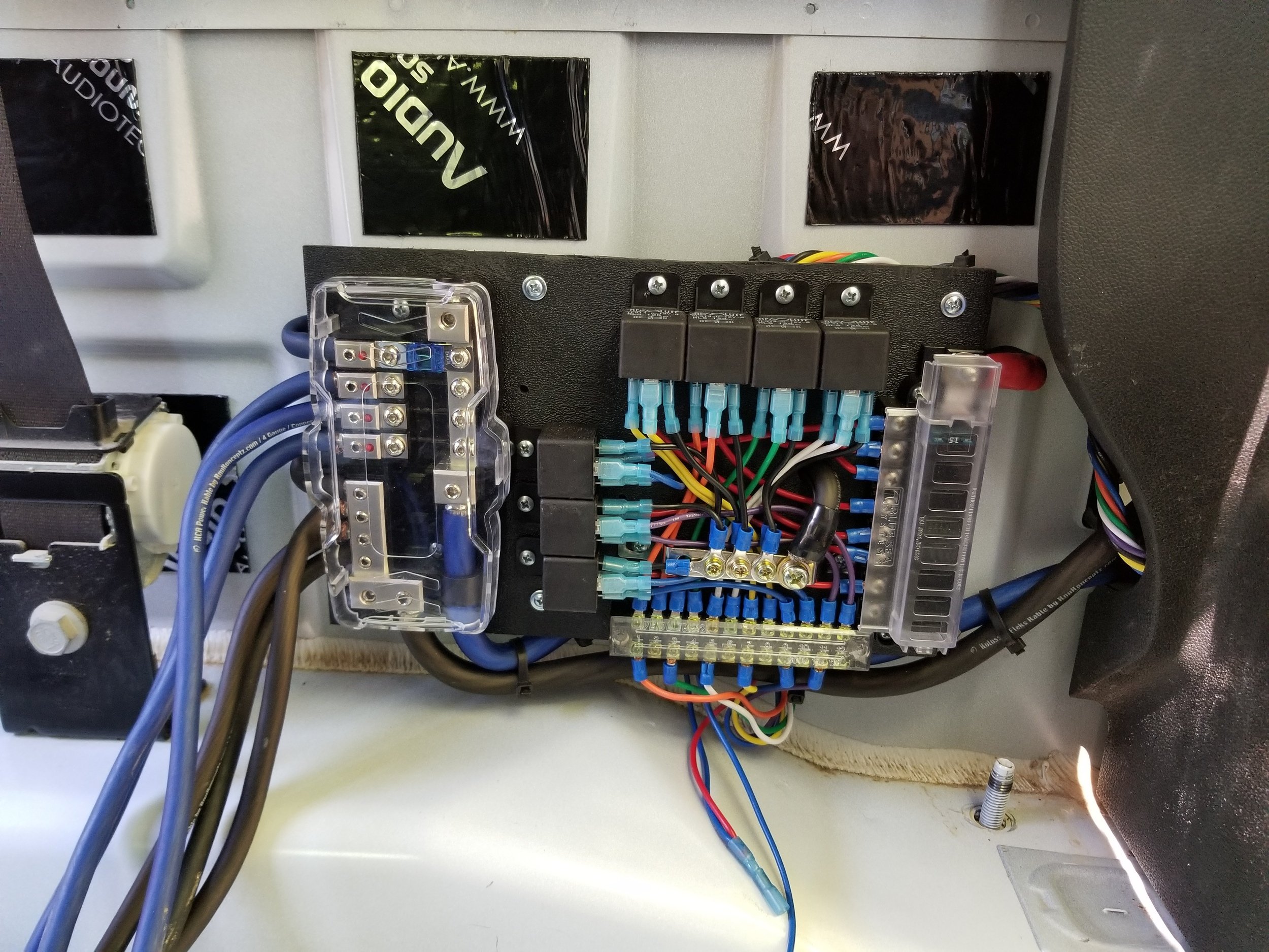

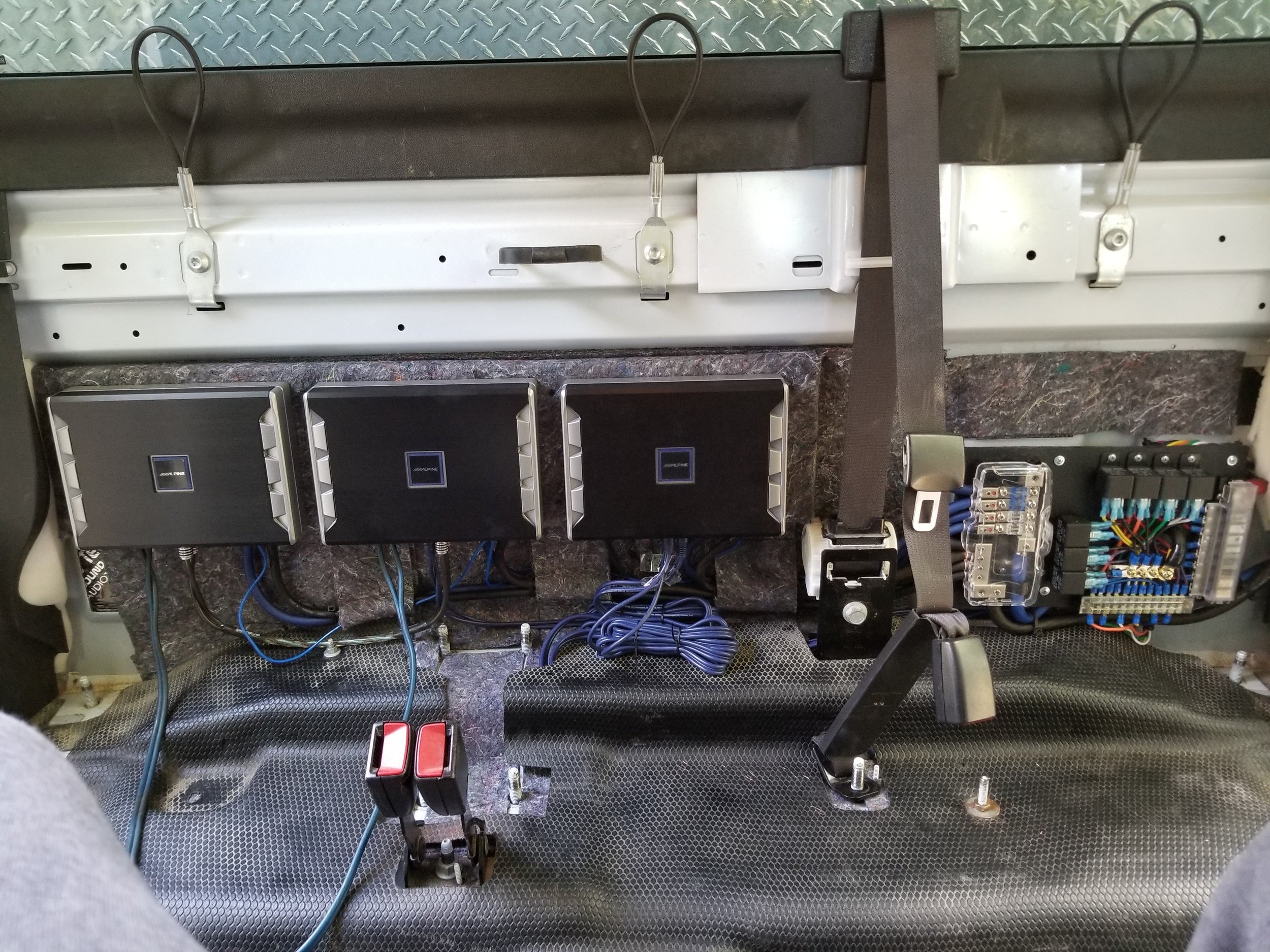

I'm running a dual distribution block (with 250amp fuse coming off the battery)...in the block i got a 50amp to my 4 channel (the kicker) and 100amp to my sub amp (a vfl monoblock)...you should check to see what fuse ratings the manufacturer of your amps recommends and stick to that though
Nice, such a clean setup. The amps seem as if installed with a ruler and a straight edge.
I noticed some of your wires are not fused. Is that for future expansion or is all that already in use?
All the amps were fused in the first pic and the mini fuse block would individually fuse each relays output. At the time of that pic I only had the relay for turning on the amps and switch panel lights hooked up thus only 1 fuse on the mini fuse panel. All the colored wires on the bottom are trigger wires coming from the switch panel to each relay. The outputs end up being the same color on the bottom board so I can easily identify the circuit on the terminal strip without yanking the rear seats
I've been through multiple setups using that fuse block. Even a 220amp draw d5.1500 couldnt fuse that high on the distribution since it's 1/0 wire and higher than mini anl fuses go but they have a 1/0 pass through and dual grounds so the fuse block became my hookup point
