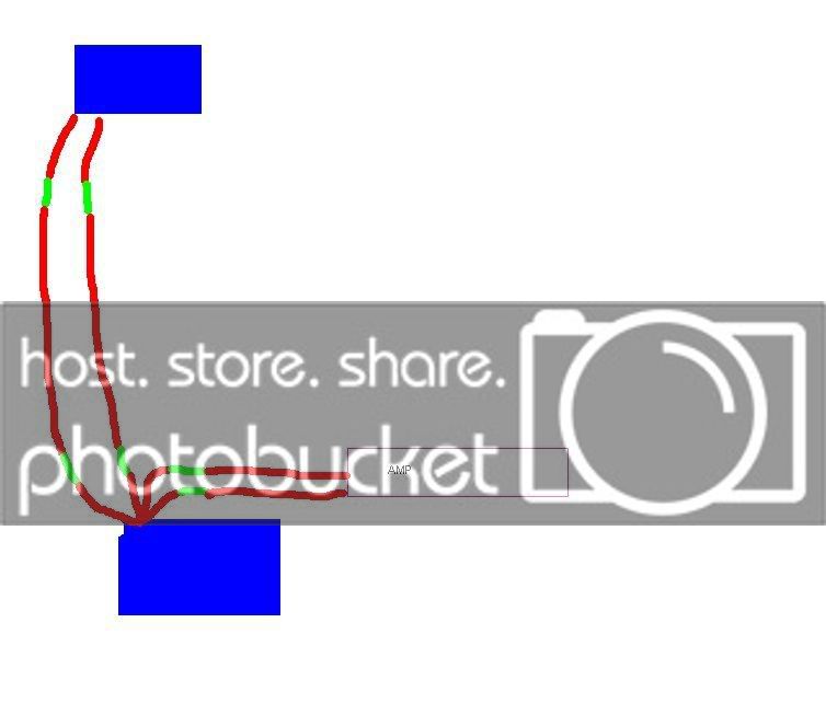

Alright I made a diagram. With all the green being fuses. Does it look right?
That's right. why bump it? You drew it correctly. You always fuse at the amp (unless the amp has it's own fuse) and at every source of power as close to the source as possible - which is each battery, just like you have drawn.
Yep.
