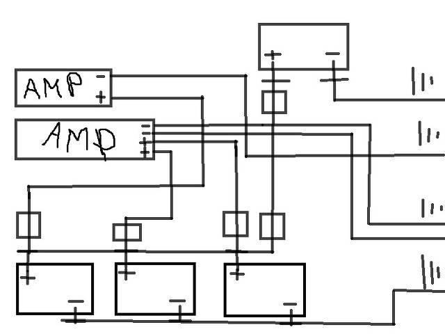

hi everybody,
im planing my new system but im a bit confused becuz of much fuses im thinkin about
but pictures says more then 1000words i am right with the fuses?
i am really need that 8fuses ? Oo
The head unit should already have a fuse somewhere in the wiring harness. You also need fuses on the + power cords coming off the batteries. Unless you have more components to wire, that should be all you need. All of your components, active or passive, have fuses.
Since you are going to use 3 batteries, I assume you have a fairly complicated system that will demand a lot from the cars electrical system. You want to make sure things like the alternator, voltage reg, and anything similar, are high quality. Getting that setup correct will insure that you have less problems down the road.
if you put hte batteries close and isolate them from shorting out to the body no. I wouldn't waste my time with it..
---------- Post added at 11:05 AM ---------- Previous post was at 11:05 AM ----------
also you only ground close to the power source. AKA close to the battery..
allright guys seems better for me too appreciate that //content.invisioncic.com/y282845/emoticons/smile.gif.1ebc41e1811405b213edfc4622c41e27.gif

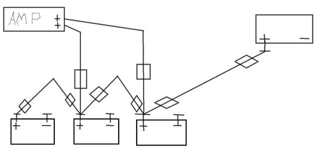

hi everybody,
i don't think u need fuse before the battery overkill, so u could leave those 2 off
