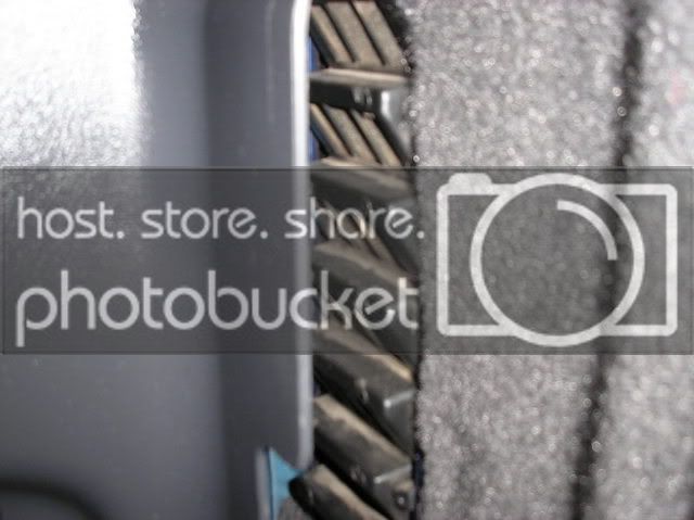

These vents on my back wall open and rattle when the bass hits. I was wondering what I could do to fix it with out closing them up. I want them to be fully functional.
get some EXTREMELY porous foam like packing foam that won't restrict air flow too much and pinch them back there, vents will still work, air will still flow at a mildly reduced weight, but the pressure of the foam should stop the rattling.
