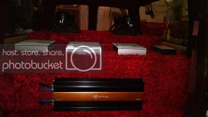

And to tell you about how I got to buying them. I read Taylor Fades test on them with a few other subs and the FU Audio subs came in 2nd to the DSS Ethos 12's which is a great sub that I have seen in action many times. If the FU Audio 12's can hang with them for half the price, then I had to try them. Then I seen them taking a beating for my self. I was sold. I have to say when opening them up I was very please on the build of the subs. I'm very shocked that more people haven't picked these up for the price you just can't beat them. I must say I'm so glade I did not miss out on these. I have a few other sets of new 12's I passed up to build a box for these first. Frank Yu was a big help on getting all the info I requested from him. He has AAA+++ customer service that I would expect. I will try to get some more pictures up when I can. I have just been so busy I still have to find the time to finish out the Astro before something else happens.
yes, they will take a beating. Yes they will take over rated power in a correct enclosure on good un-clipped power. Yes, they are very affordable. They are built in the US.
I have been running them for months now. Four 750-15's in a custom octo-port enclosure tuned at 26hz. On a Cresendo BC5500 at .5 ohm on great electrical. I'm hitting 140.7db down at 17hz. I'm at 148.5db by 28hz. And the build peaks at 40hz.

That sounds great. I believe I finally settled on some subs. My finished sub stage will be 4 of the fu 750 on 2 1.8k ts. Oh yea how much port area should I give these per foot. And thanks for the help
half SD should be plenty. Can go a bit higher if you want, doesnt affect frequency response as much as other subs.
Sorry for the noobness but the sd is 95 then /2 is 45. If I had one in a 2.0 then that would be 23" per cube. Seems like a lot but I am new to this and could be wrong all together.
