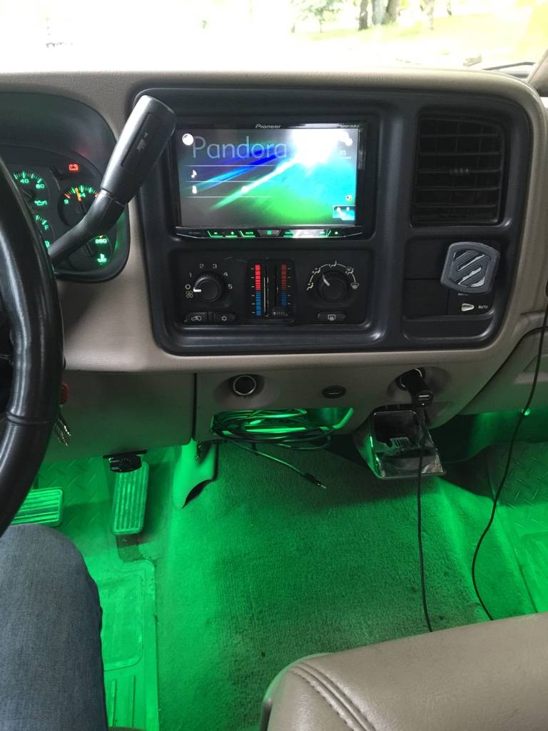

Pioneer avh-4000nex DVD headunit

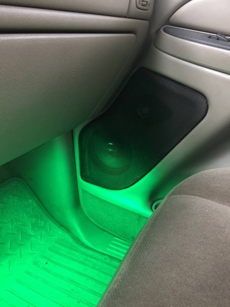

I installed led lighting in footwells along with the center cubby

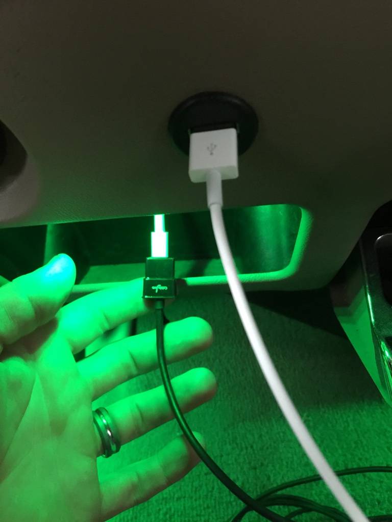

Usb1 port mounted between 12v power outputs and the white one in my hand is connected to usb2 and hdmi for video streaming along with a cable jive dock extender... As far as I know only cable on the market that works for data transfer for the iPhone 5-6... I roll with the 6plus

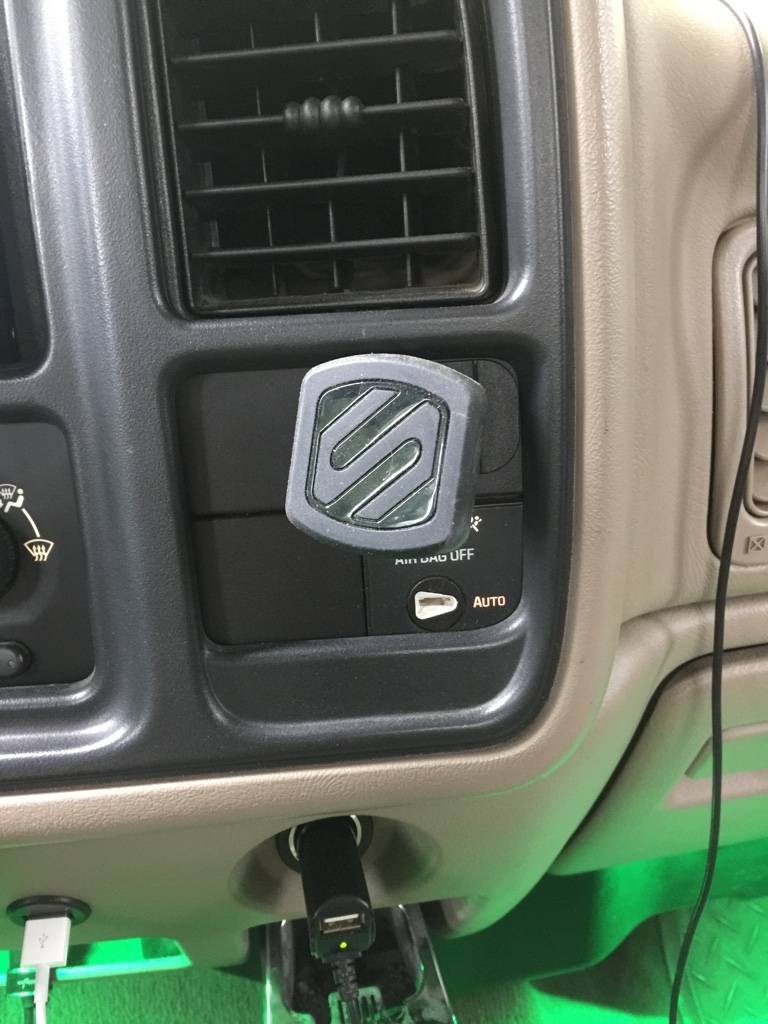

Magic mount magnetic mount for my phone

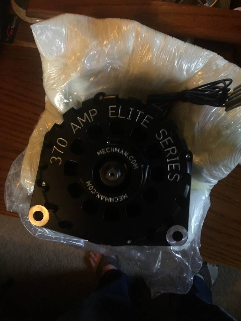

Just got this bad boy in the mail yesterday
Mechman 370a elite

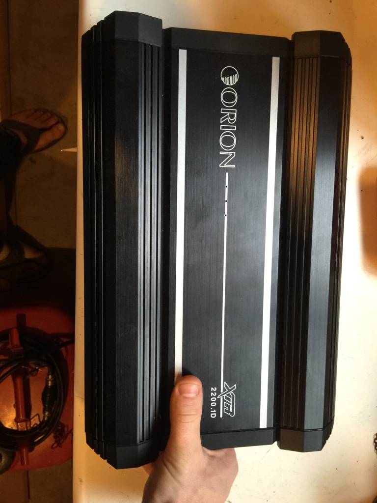

Orion xtr 2200.1d to power these mini monsters

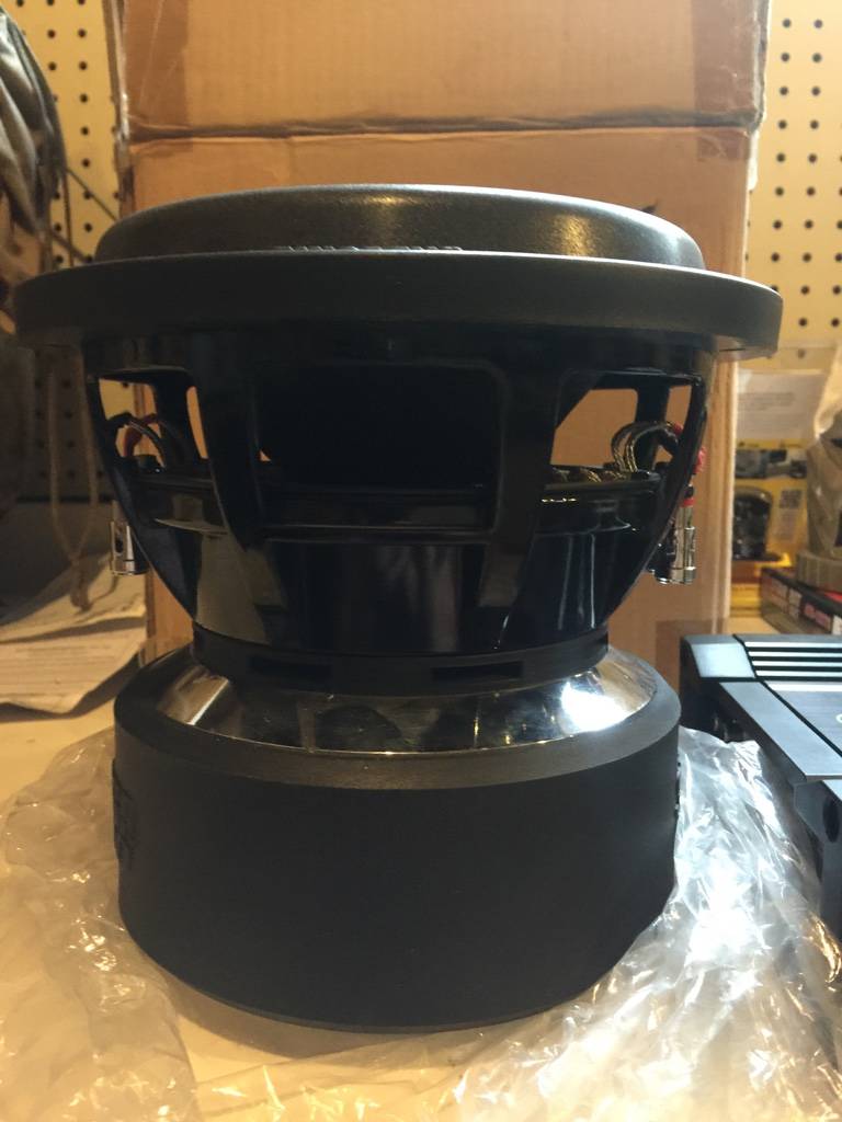

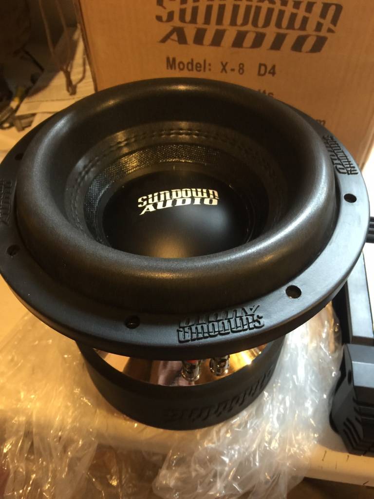

2 sundown x8's d4 will be wired to 1ohm

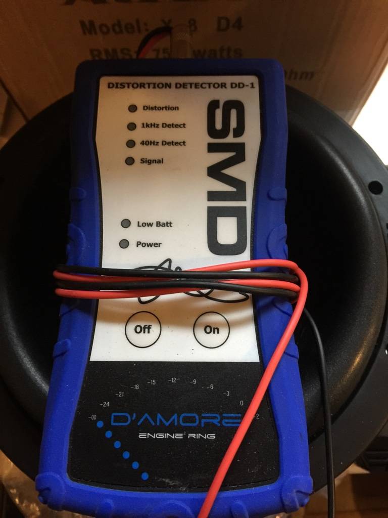

Gains set with d'amore dd-1

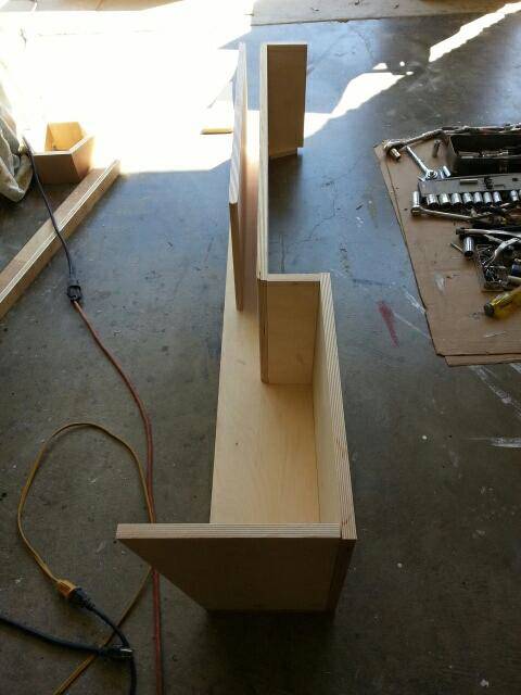

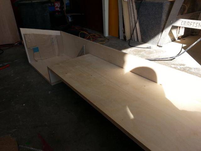

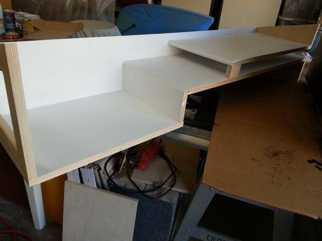

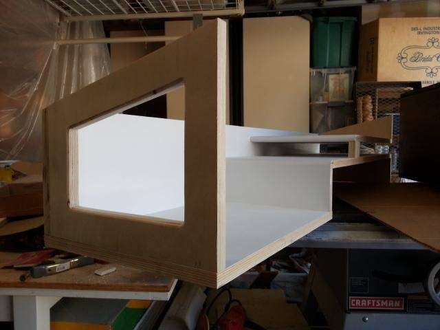

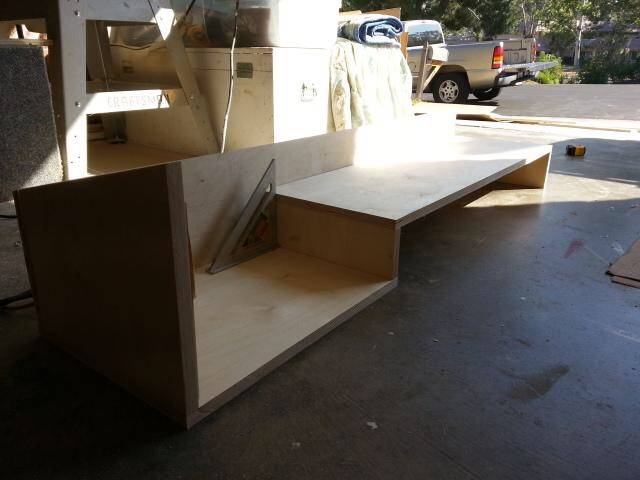

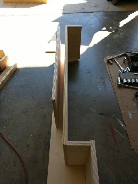

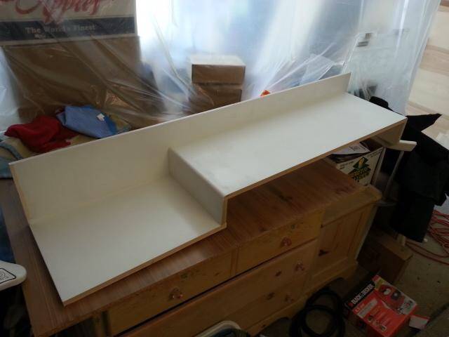

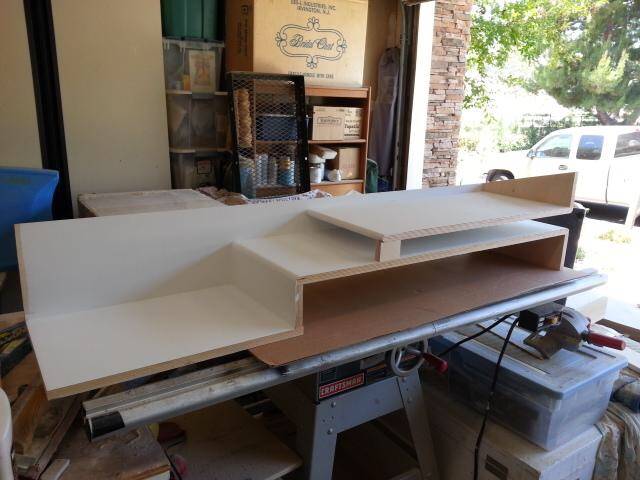

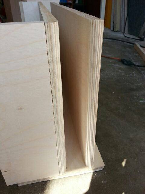

Box is being built over the next few days by the one and only CSCStang... 2cu tuned to 33hz with 28in^2 port area

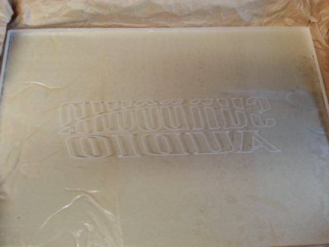

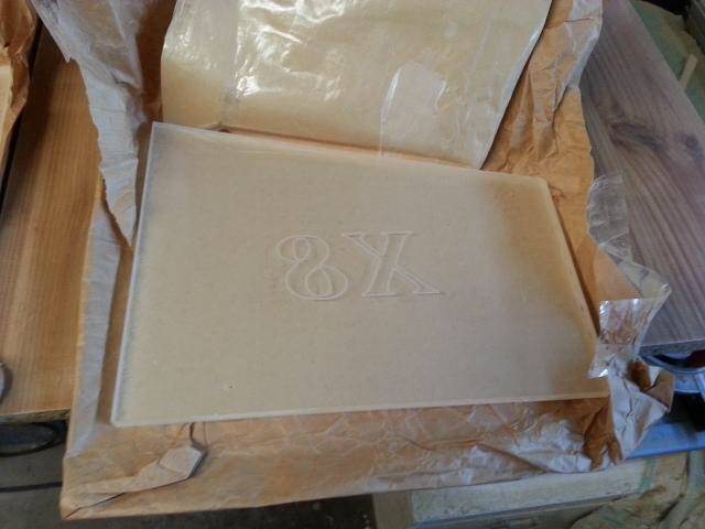

Plexi was received today for the top and side of my box will be back lit green and painted white interior
Once I get the box I will be staining it a nice mahogany color and poly to seal it with a glass like finish
Will be posting pictures of the box progress as I receive them from CSCStang

good build so far, i have some pictures of the qlogic kick panels installed in my truck, interior is nearly the exact same so you can see what they'd look like.

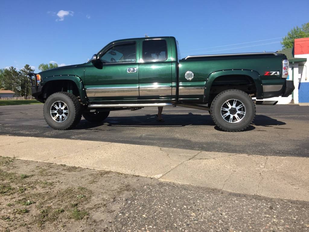

1. That truck does not look like a beater to me
2. I would have picked something besides that Orion to power some X8's. Just my two cents
3. Scope>DD1 any day
There's dynos on these xtr amps and they do rated... We will see how it goes

[quote name='els1989']There's dynos on these xtr amps and they do rated... We will see how it goes
Sent from my iPhone using Tapatalk[/QUOTE]
Hmm, thought the newer stuff was over-rated.
I did see some dyno's of their OS stuff, and I was disappointed by their actual output :(

Yea the old school claims to them doing over 1k on a 250 or whatever were complete bogus... But whatever in all honesty some of today's amps do way over rated than what those old schools did... And yea it does over rated I'm pretty sure it's rated at 2200 12.8v so I hope with box rise it will be running the 2200 to the two... But yea they do over rated
You'll be surprised by how much power rise takes away.
Wired at 1 ohm nominal, be prepared for a bit over 1k.
At .5, you may be lucky to get 2k clean. Just letting you know.
T fade gets great numbers for amps when he wires them to .25 for burps.
Well I'm pretty confident in stangs build skills... Fingers crossed for only 1ohm rise that will keep me close to 2k
