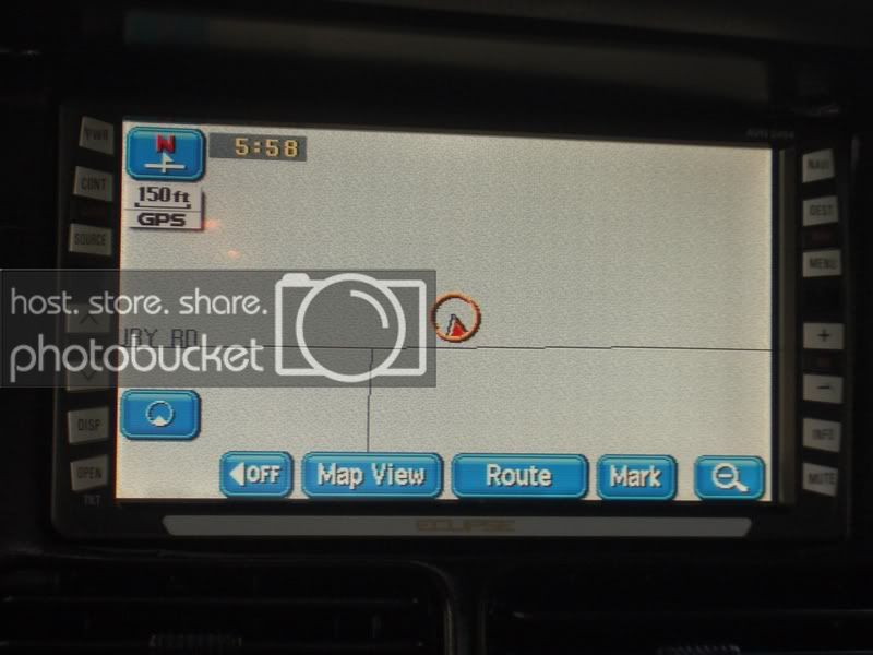

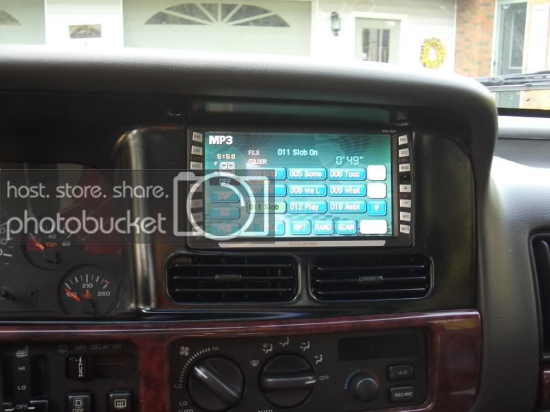

Eclipse AVN2454 Navigation Headunit w/ backup camera

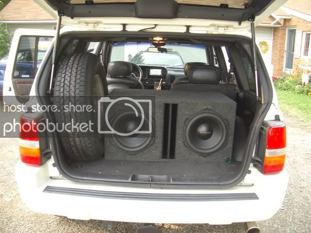

2 Cerwin Vega Stroker's 2000w rms 4000peak each

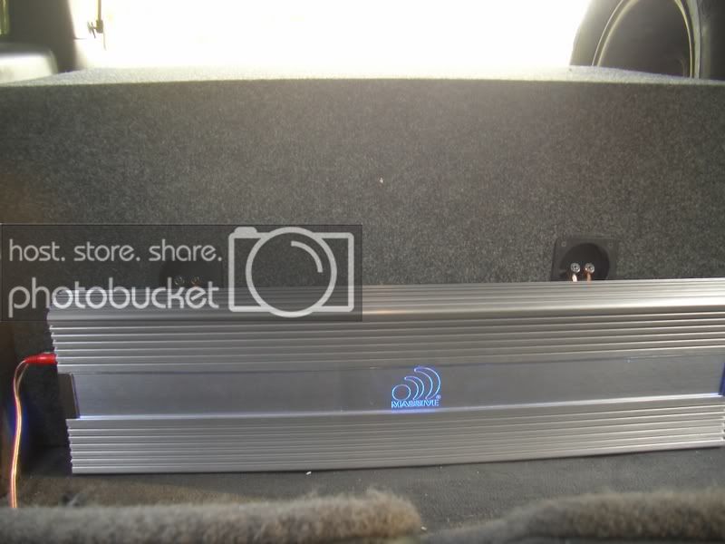

Massive Audio P3000.1 3000wrms @ 2 ohms 6000 peak
The problem seems to be that even with a stock high amp alternator and optima red top battery the lights still dim horribly on hard notes, to the point where the amp clips as it's not getting enough voltage. What would be the best way to correct this problem? Optima yellow top, Kenetik 2400a, Capacitors, and other smaller Kenetik batteries mounted inline of the amp all come to mind, I just want the simplest and least costly route. Is it true that they say capacitors are only good for a few good hits and then need to recharge? Anyways, here's some pics of the install.

Thats a killer amp, alot of people dont realize how good those are.....its basically two strapped 1500 watt amps built into one case FTW //content.invisioncic.com/y282845/emoticons/eek.gif.771b7a90cf45cabdc554ff1121c21c4a.gif

The Amp seems to be putting out serious power, so much so that I had to have the installer turn it down as it was drawing too much power and clipping badly....I can't wait to hear this thing tuned up full gain volume way up!
The dash work was custom done by a local shop Custom Car Audio here in Jamestown Ny.

if you're pulling 3000 watts on transients, you'll need 268 amps @ 80 percent efficiency. The stock alt is a bit over its head on this one.

btw... the gain is a level selector, not a volume control... it usually shouldn't be all the way up.
