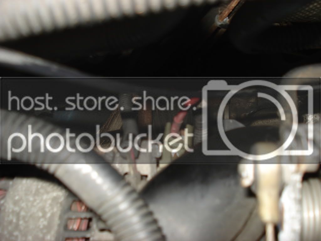

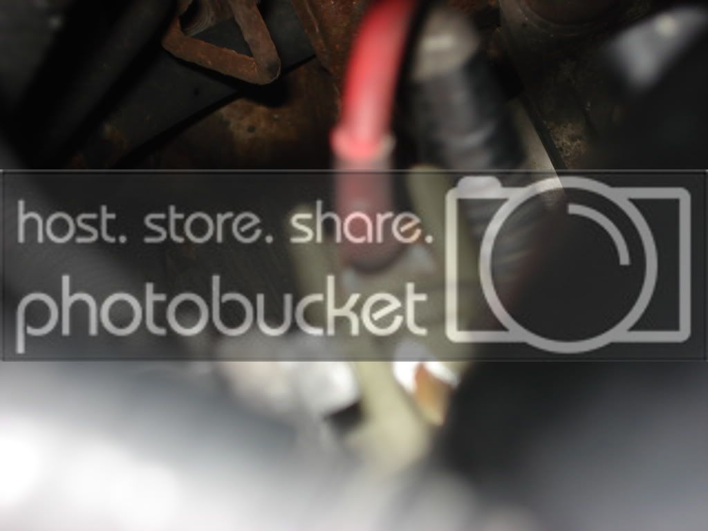

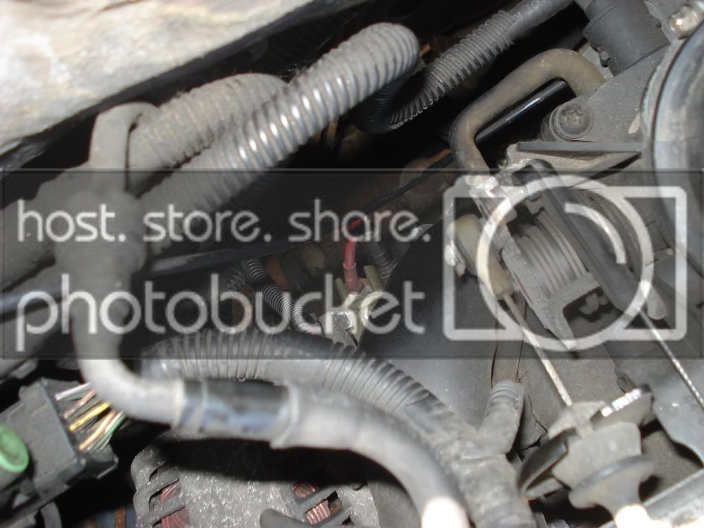

So i found where the positive lead comes off the alt, Deep in the engine bay. So its really hard to get to which makes it a pain. I get a socket on it, 3/8 if anyone cares, But when i start twisting it, it moves the hole plastic piece with it and wont turn the bolt and i don't wanna use too much pressure cause i don't wanna break anything. Im turning it towards the driver side. Is that right. I think that would be left loosey.
Anyways, once i even get the bolt off if i ever do. How in the hell am i supposed to fit a 0g terminal on that, It has plastic covers up the sides. Do i have to crack them so i could screw on the 0g?

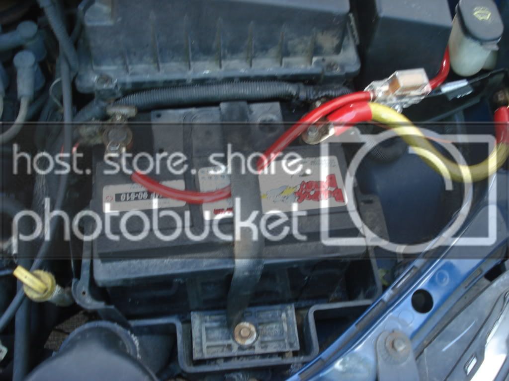

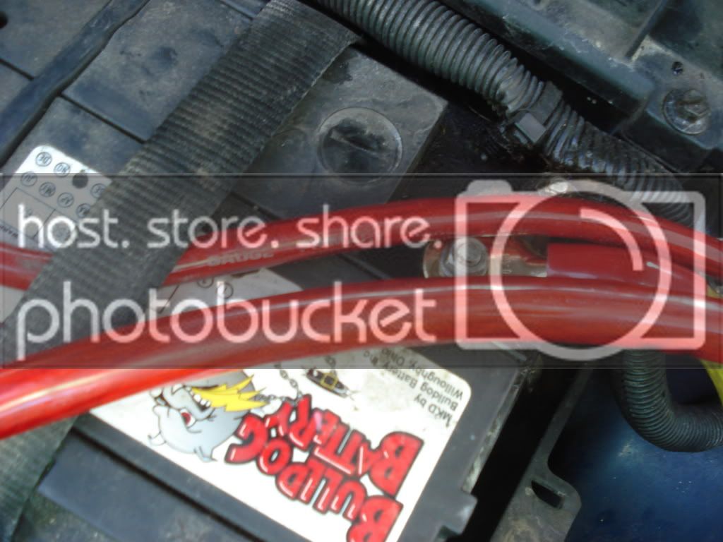

Side note: And damm got the wire and anl fuse holder + fuse from scotty today and it makes 4g look puny! No way could i ever run 0g through my car, that is some fat wire! Ill snap some pics to show you what im talking about with the alt

4g next to 0 :O

Apparently im having the same problem he did, with the tower twisting. As i have tried and tried and cannot break the clips going up the sides of the tower i guess i just may have to do a run of 4g... which next to that 0g is going to haunt me. Its really my only option i suppose as i wouldn't wanna dish out money to a shop just to put on a wire for me..
let the shop do it! i had 4 gauge all around. power and big 3. then i changed all 4 wires with 1/0. an i promise theres a way. u just need the will to do it. i have 4/0 power and ground going for my power wire through the engine bay and i have like 0 engine space. u just need some willpower. thats what i had to do. just buckle down and do the deed
