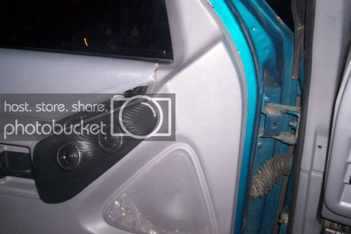

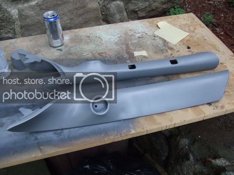

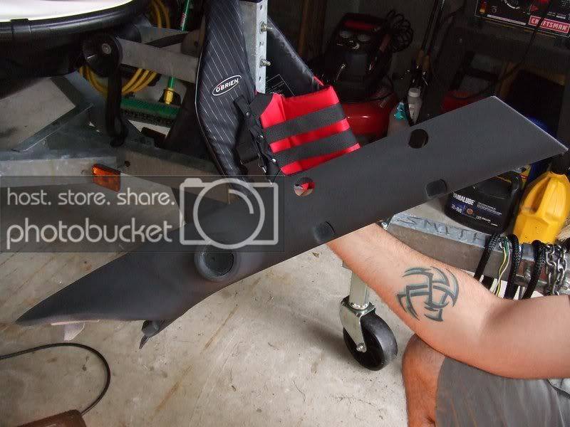

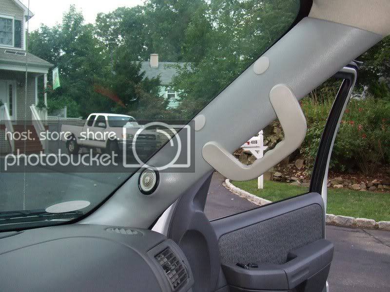

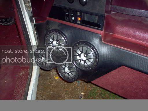

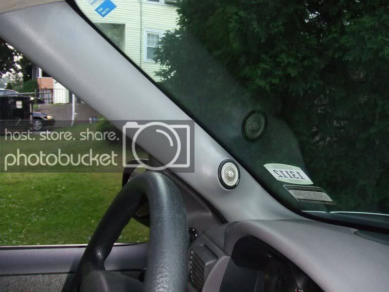

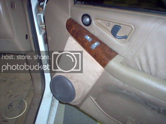

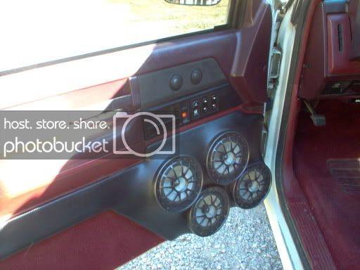

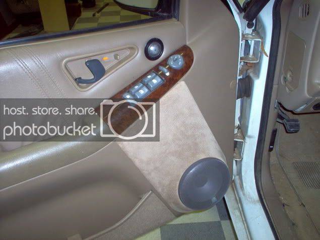

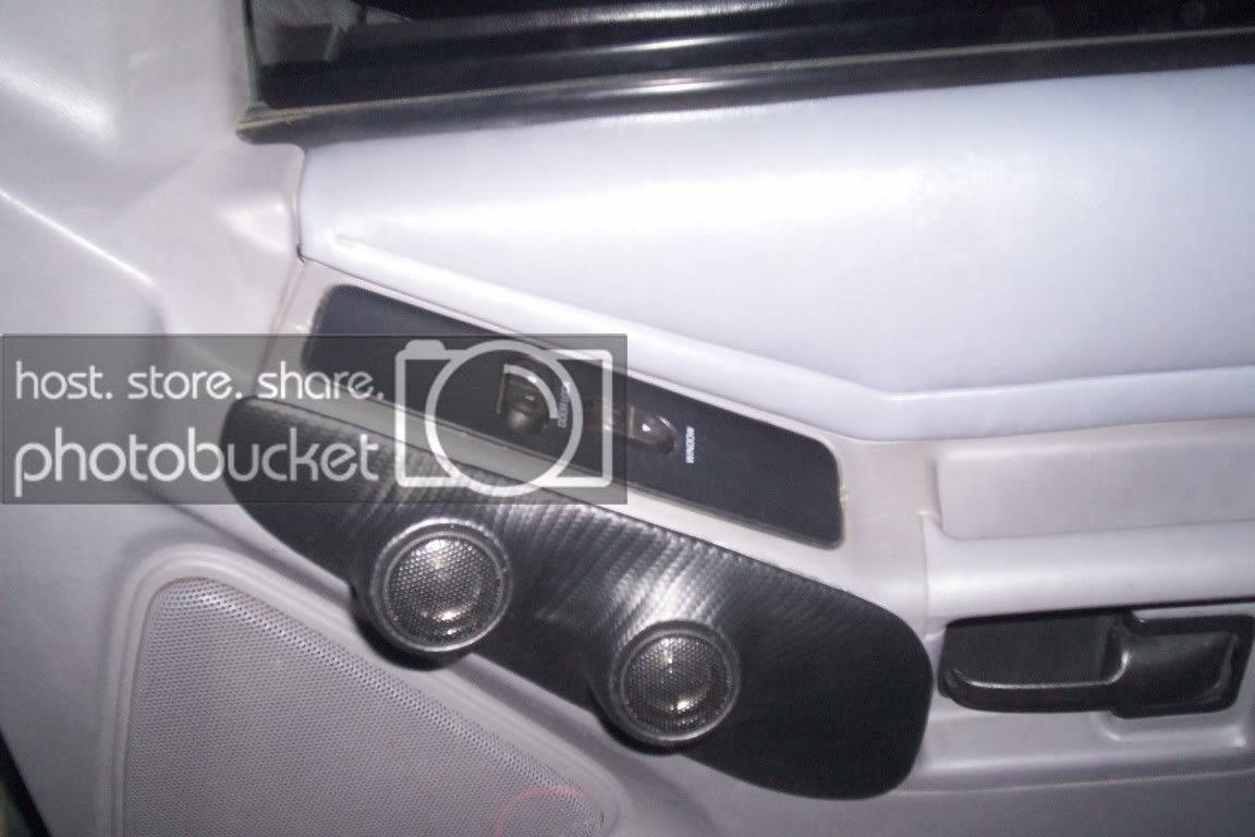

Here are some other panels and fiberlgass jobs i've worked...if I'm hijacking let me know and I"ll delete all of this
