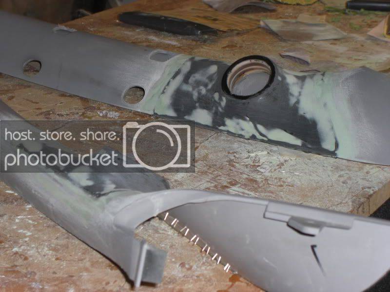

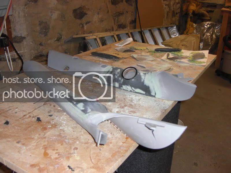

do those staples cause any problems when try to smooth out the surface between the FG and the original mold?
Nah. A little rage gold and or duramix 40/40 and some sanding and they are good to go. The staples I use are uphostery staples that I shoot with my air stapler. They are thiner than the staples most would try using with a manual gun.

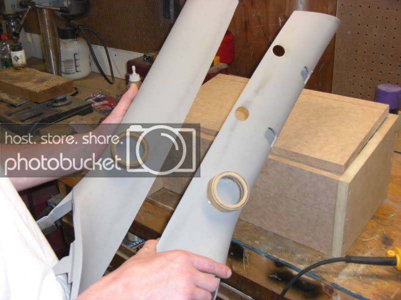

neverenough, why the fiberglass on the panels?
Why not just mold up with kitty hair?
Not trying to be a smartass, just the way I did mine in my old silverado...
Those came out nice. Didn't have any kitty hair, cause I don't use it too often. Guess I'm just used to using this method for making pillars, hasn't failed me yet.
understood totally, to each their own!
Would save some time on future projects though, its alot easier to hit kitty hair with a DA then throw some rage gold on it and knock it down.

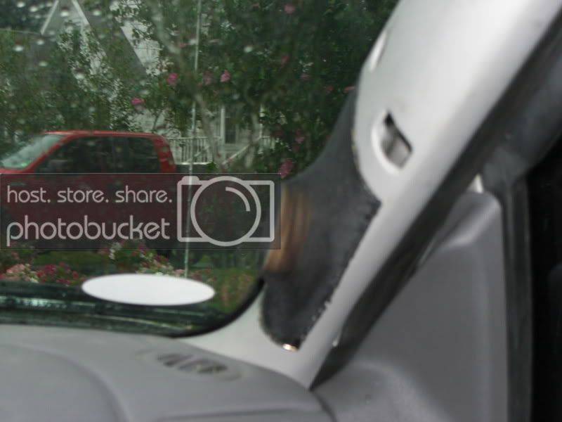

I did my old girlfriends explorer with fiberglass like you did, I might have went to thick on the glass or something...dunno but it was a pain to get it to feather into the panel like I wanted it to. Then again I have only tried it with glass once so I'm sure there are some tricks to get it to lay right.
