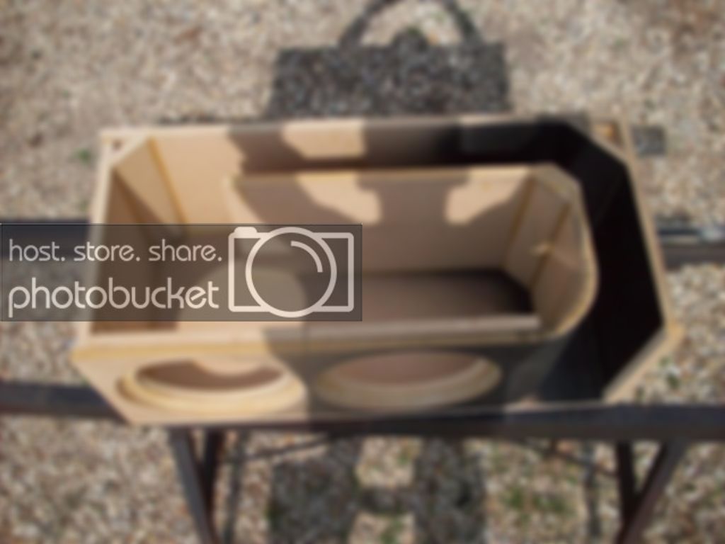

Flared ports...how you do that
Soooo ... How do you calculate for the curve? i.e. The port has a certain volume without that curved section, and with the curve added the port's volume is larger.

usually .5" increments between the cuts will make almost any turn but to do it the right way so the cuts all touch and create a single surface on the inside requires some math.
Draw it up on sketchup, highlight the outside of the curved area of the panel and see how long it is, then highlight the inside of the curved area and subtract the inside length from the outside to see how much material has to be cut away to make it perfect..
Then devide by your blade's width and you have the amount of cuts you'll need (if it isnt a whole number just round up)...then you'll need to do the math for the spacing between the cuts to fit the 'X' amount of cuts within the 'Y' amount of length the kerfed portion is on the panel..//content.invisioncic.com/y282845/emoticons/smile.gif.1ebc41e1811405b213edfc4622c41e27.gif that would be the perfect way of doing it imo, to get perfectly 'mated' kerf cuts on the inside.

FYI ... As an example, that curved section with a 4" radius curve and a height of 12" (using the box picture in OP's original post) adds 41.2 cubic inches to the port's volume. (Same but with a 5" radius adds 64.4 cubic inches).

When doing port calculations, neglect the flared portion...so port area is the same, it's just a little bit shorter so your tuning will raise...which means you'll need to compensate by adding a few inches to the length.
The flare will also cut a bit off of your airspace, so you may have to adjust your dimensions and port length when adding a kerf to a design..
And port volume has nothing to do with tuning, fyi

Ports have specific height & width (aka area) and depth (the part of the port that is typically inside the box), no? That's volume, no? If volume doesn't matter, why not just leave off the part of the port that's inside the box?
I meant when calculating the tuning of an enclosure you need 3 things:
-Net airspace
-Port area
-Port length
So in a way, yes...the port volume will effect the enclosure but you never use the volume of the port in the math itself...just the two numbers involved with the port.
Does eliminating the 90* angles inside the box help the end response? For instance the box in my original post had braces placed on all corners.
