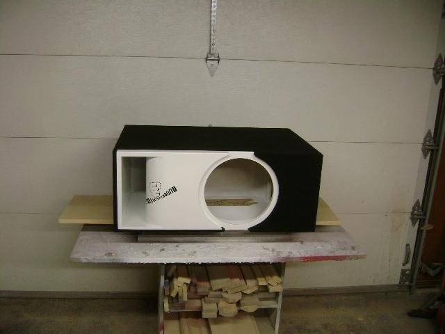

So I was just checking out SSA forum andsaw these flared ports

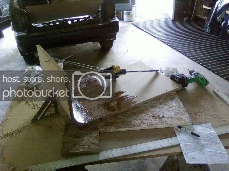

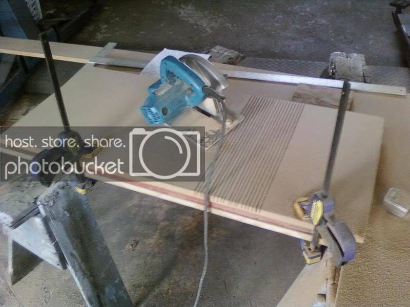

I understand that you have to cut slots in the board to create the curve, but how do you get the mdf to bend like that?
thats what the cuts are for //content.invisioncic.com/y282845/emoticons/wink.gif.608e3ea05f1a9f98611af0861652f8fb.gif
edit* the wood is very thin on the other edge of the board so it just flexes but does not break

How much of a gain do you get from it?

What benefits do you get by eliminating the 90' angles?
How deep do you cut?
