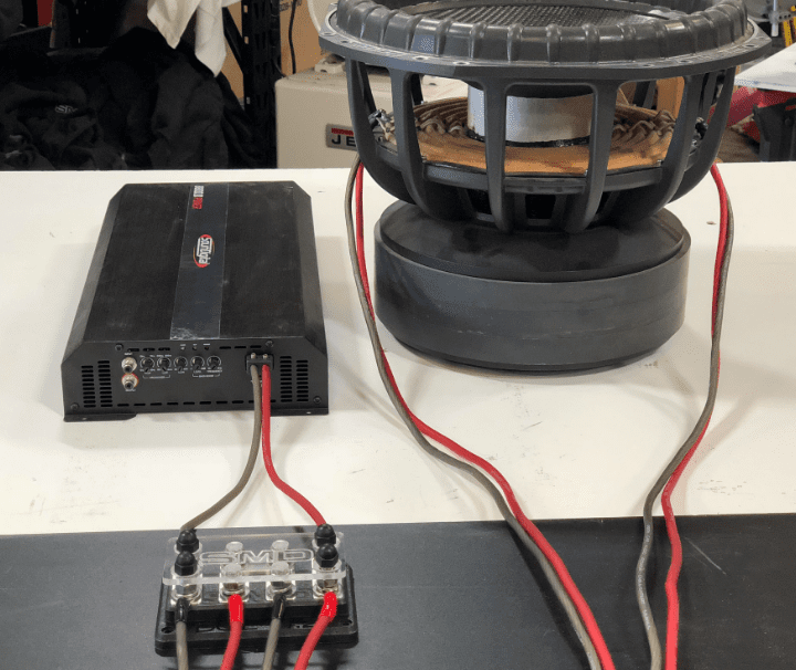

How do you fit multiple heavy wires under a speaker terminal when trying to wire a DVC sub in parallel? It should be irrelevant; but the sub is a 15" L7, and the amp is a ZX1500.1. I want to run 10 gauge wires (but I'm open to suggestions), but no way in hell I can fit two wires into the L7's terminal!
Run a wire to each terminal. Then twist negative wires from each coil together and connect to a single long wire going to the amp. Then do the same with the positive wires. I'm having a hard time finding a picture to explain.
A D block would work as well.
