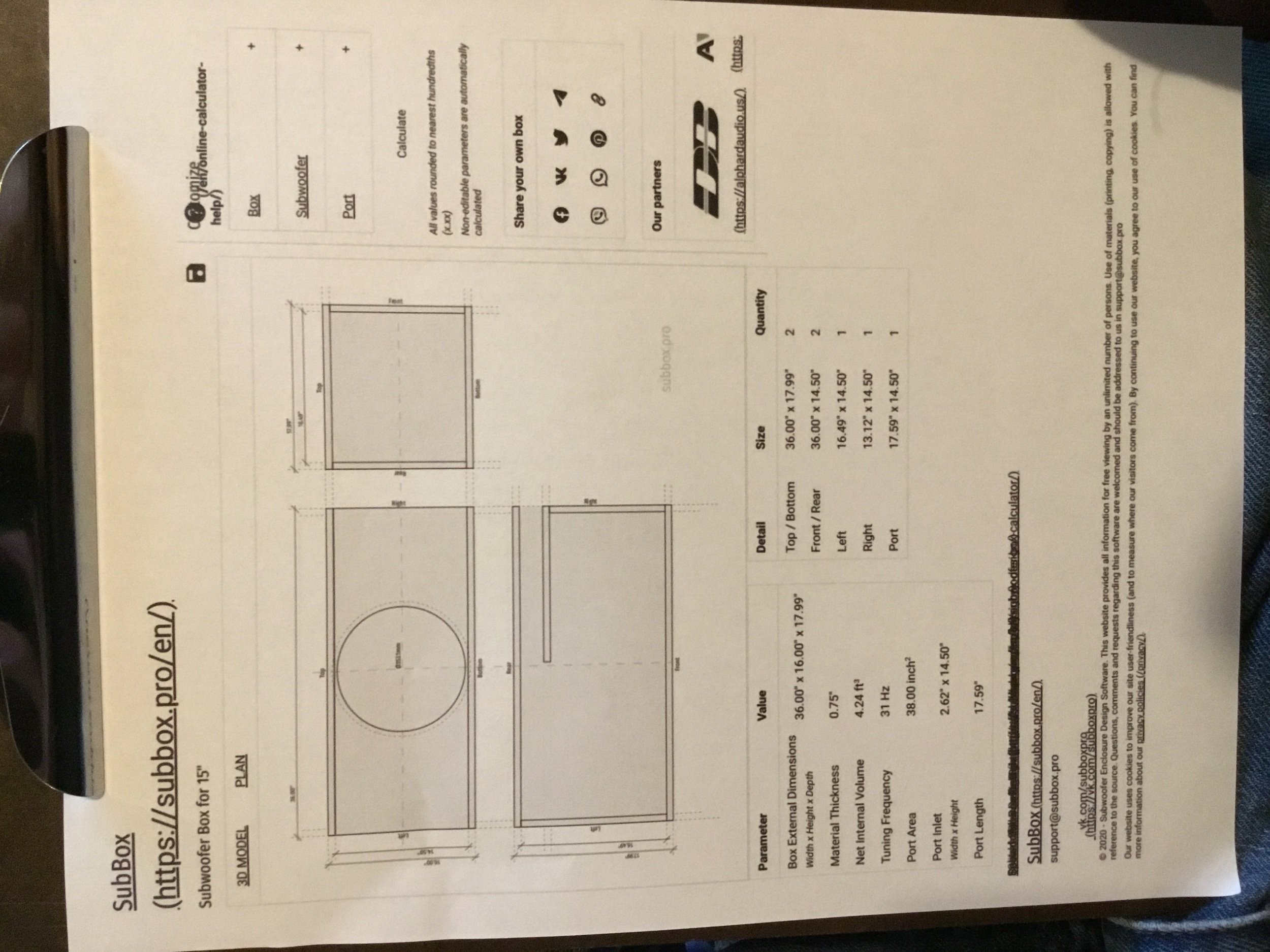

OK here's the "List"
Vehicle: 2001 Toyota Celica gt hatchback
Location in the vehicle: rear trunk
Space available: approximately 43"wide, 25" deep, 16" tall. I could go as tall as 20"
Subwoofer make & model: Resilience Sounds RS 15" D4 - 500w RMS here's a link to it https://www.resilientsounds.com/product-page/rs-15
Subwoofer size: 15"
Number of subwoofers: 1
Type of Port : Slotted
What type of music do you like: 90's - 2020 rock / hard rock, 90's rap, dub step
What is your goal SPL or everyday music: everyday music
Tuning frequency: 31 but not sure what I need or want
Volume: not sure what this means
Questions: here's the box I think I'm going to build any input or tweaks I should make? Should I redesign? Also what size amp should I get. This all new to me. The last any kind of system I had was almost 20 years ago and it was a 200w mtx amp and 2 radio shack 8" subs in my 89 Ranger lol
If you don't want to click the link I've attached a pic of the printout. The website in the link is https://subbox.pro/en/ if you want to check it out. Thanks in advance for any help.

What amp are you going to use? What are you running for mids/tweets? Amp?
I have no idea what amp to use, I'm looking for recommendations on that. As for mids and tweets it's just what's in the car already, not sure what they are but I don't think it's factory. The guy I bought it from had a sub in there cause there's a power and ground wire run back there.
Taramps MD1200 2 ohm version should work fine with that sub.
The box should be to the specs of the sub. Ported will be best. Just a guess would be, 1.75 cubes net tuned to 32-34hz.
I don't have the sub yet, it's being shipped still. The box I built on that website is 36x16x18, Port is 17.59" long, port area is 38 square inches , net internal is 4.24 cube ft, Port inlet is 2.6" wide & says tuning is 31hz
