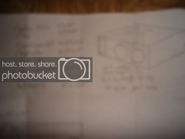

Anyways, I'm building a box for my subs because the prefab sealed one just doesn't seem to work for me anymore. The subs are two 10" crap *** Kicker Comps, but whatever, they get the job done for me //content.invisioncic.com/y282845/emoticons/smile.gif.1ebc41e1811405b213edfc4622c41e27.gif Anyways, as you can see in the first picture, I sketched up a design came up with some dimensions and calculated it all up.
The box stats are as follows:
(All external dimensions)
Width - 32"
Height - 14"
Depth - 20"
The port is 12 1/2" tall and is 4" wide for a total port area of 50 sq.in. The port path is also 30" long and with the port volume and subs subtracted from the box, it comes out to just about 3.1 cubic feet with a tune @ 35 Hz.
I think this box is a bit overkill for two 10" comps but what the hell, may as well get the most out of what you've got so I'm giving it a whirl.
Not only is this my first box build, but it is ported as well so this is full of lolz.
Enjoy (Not 56k friendly)

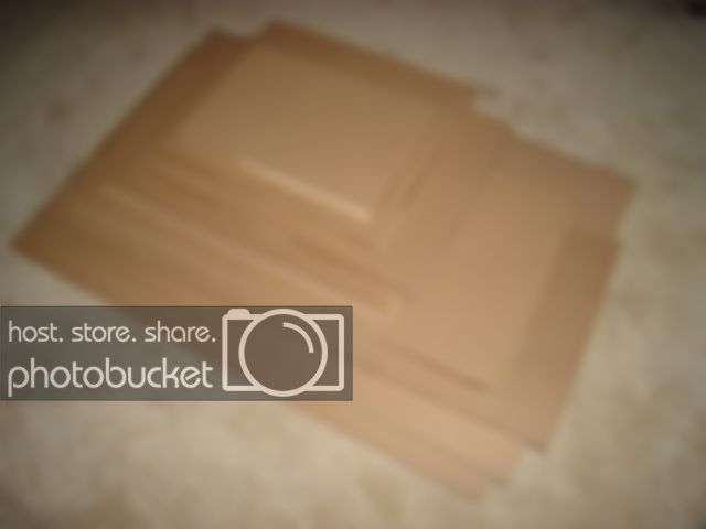

Here's my sketch of my box and what it "will look like" (Hopefully) I also made a cut sheet so I could tell the guy at Home Depot what size MDF to rip.
Mmmm. Nice straight cuts //content.invisioncic.com/y282845/emoticons/rolleyes.gif.c1fef805e9d1464d377451cd5bc18bfb.gif

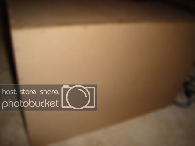

Here's a quick mock-up of what it will look like. It's just leaning against itself right now, no glue, screws, etc...
I'll take some more pictures here soon.
Not bad. They never make the right cuts. If you plan on building more I would invest in some told so your cuts are accurate. but not a bad start good luck. Predrill the holes before you screw

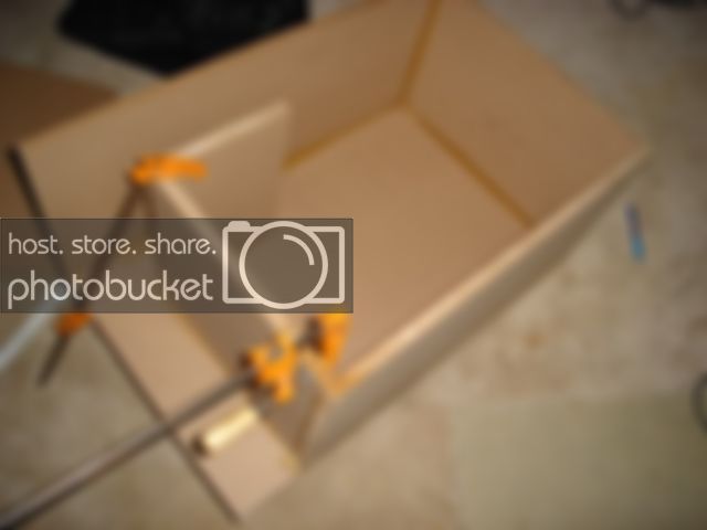

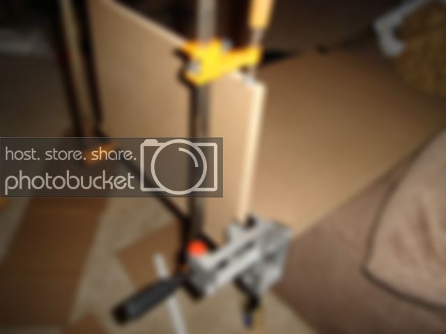

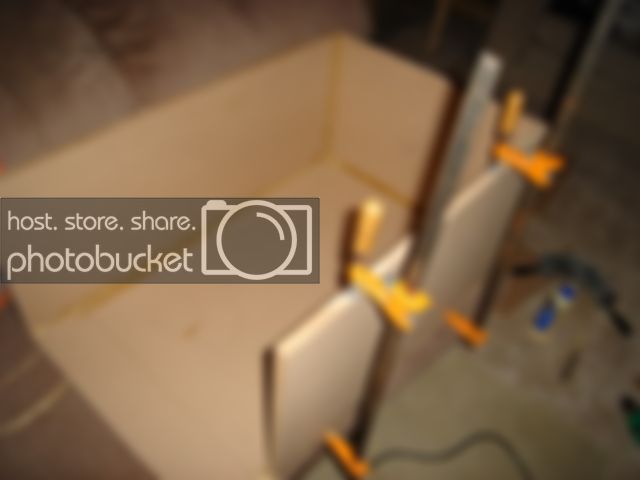

Started the first joint. The bottom of the box and the right side.
I got hungry //content.invisioncic.com/y282845/emoticons/rolleyes.gif.c1fef805e9d1464d377451cd5bc18bfb.gif

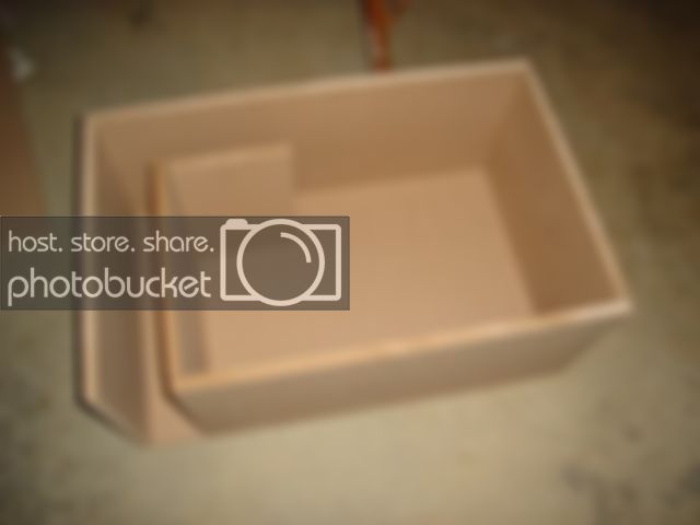

Back on track...3rd and 4th sides installed
And finally... the L port installed. I'll install the last side and the top tomorrow probably, it's late and I'm working in the basement. There's a bedroom right above where I'm working so I'm not gonna be an ******* :p
More updates tomorrow most likely. Either that, or when I can get my buddy to loan me his router so I can make some nice circles and maybe round of the edges a bit in the port area.

Box looks good man. Next time, I'd suggest getting your screws a bit further from the edges. Other than that, lookin slick.
I thought of that when I compared the rounded router bit to the screws and saw that it would hit them. So looks like I can't use it to make nice smooth corners, atleast with router anyways. I can still smooth em out by hand a bit... Oh well, it's my very first try.
