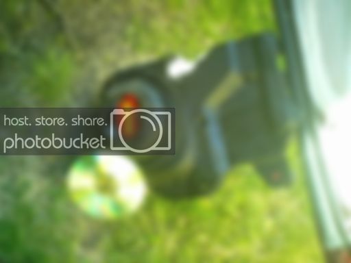

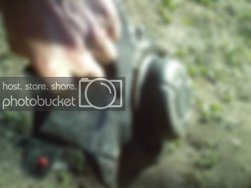

Ya so I fixed my problem by cutting holes in the back of the boxes and using the door as an enclosure. I had tried to use the crossover built in to the jl amp but it sounded bad because the speakers already have built in passive crossovers...anyways here's some pics...
Removed from the door.
Back of pod before.
After.
