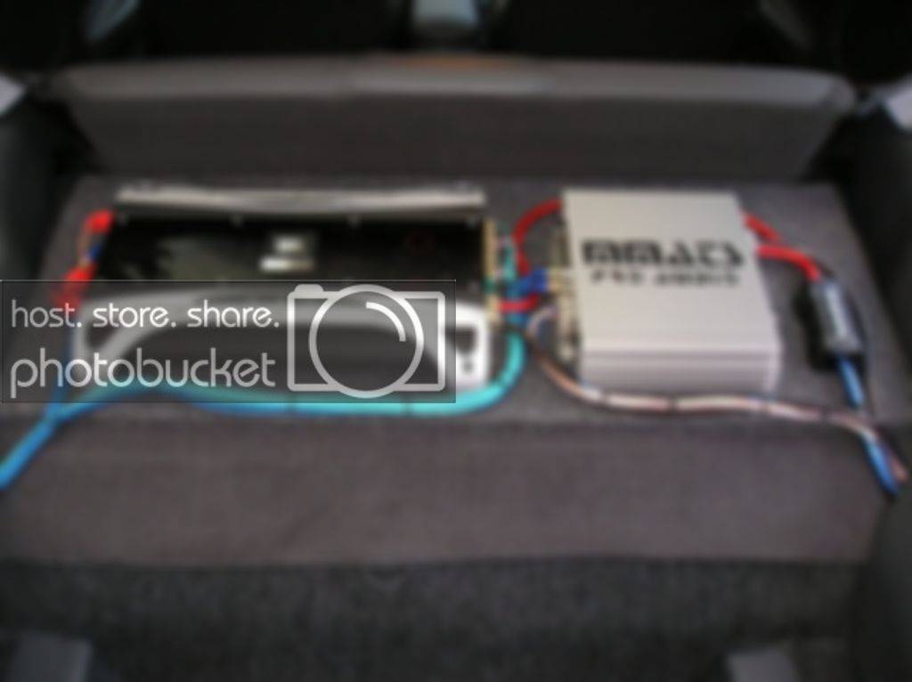

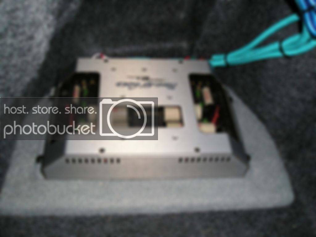

Hello guys.
I know I just finished my install in my truck, but I recently sold it for a 99 Camaro. Sorry it has taken a while as many of you wanted to see it.
I finally installed the complete stereo, which took a long time to gather the equipment as I couldn't buy all of it at once. I am VERY happy with the set up besides ONE major thing.
As usual, it has to do with the substage.
First is first, here is the set up list and pics of the final install:
HU: Pioneer DEH-P6900UB
Comps: PG Elites 6.5s (drivers made by Morel)
Subs: Pair of 12 inch TC1000s
Comp Amp: JBL Px300.4 (Bridged, over 350 watts rms x2 at 4 ohms for the comps.)
Sub Amp: Mmats D1500.2 (1200 watts rms at 2 ohms.)

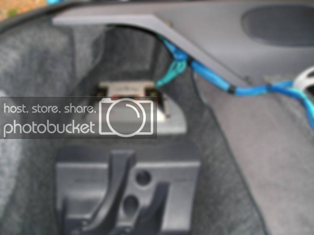

Here are pics of the install:
http://i197.photobucket.com/albums/aa127/vipervenom18/P1011451.jpg
http://i197.photobucket.com/albums/aa127/vipervenom18/P1011452.jpg
http://i197.photobucket.com/albums/aa127/vipervenom18/P1011454.jpg
http://i197.photobucket.com/albums/aa127/vipervenom18/P1011455.jpg
http://i197.photobucket.com/albums/aa127/vipervenom18/P1011456.jpg
http://i197.photobucket.com/albums/aa127/vipervenom18/P1011457.jpg
http://i197.photobucket.com/albums/aa127/vipervenom18/P1011458.jpg
http://i197.photobucket.com/albums/aa127/vipervenom18/P1011459.jpg

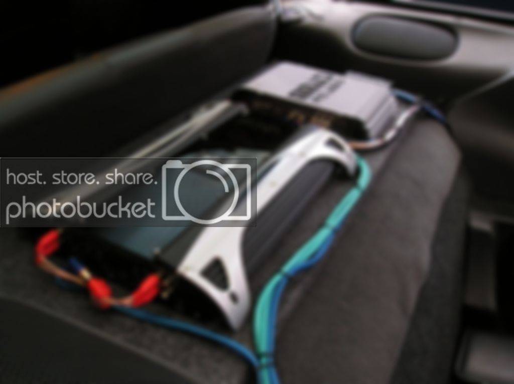

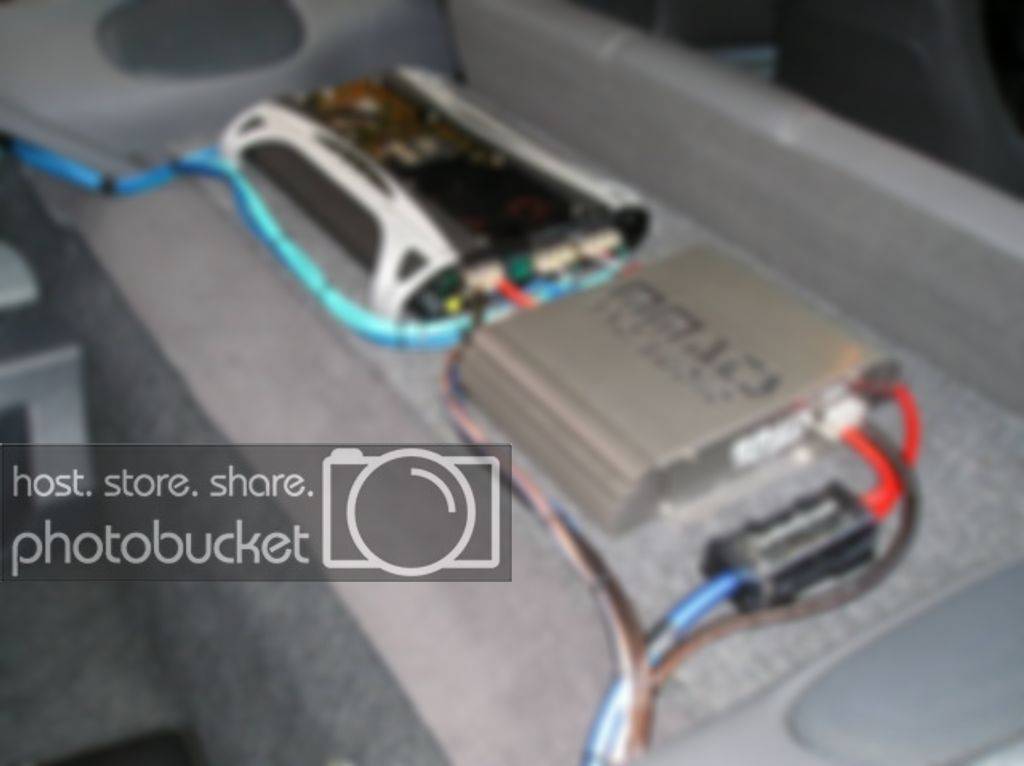

looks very clean. i am a fellow f-body owner. Actually a T/A WS6... anywho. i hope you plan on covering that wiring either with carpet or //content.invisioncic.com/y282845/emoticons/confused.gif.e820e0216602db4765798ac39d28caa9.gif I would have run the factory carpet and just made wholes instead of running cable bare like that. It is a clean instal however it would look 100x better if we didnt see the wires all over....
