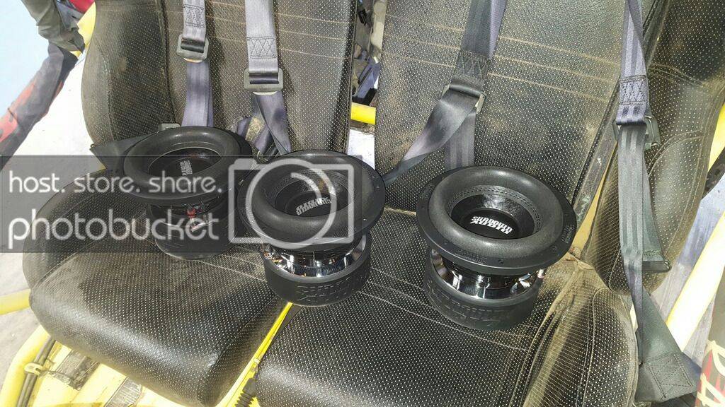

So I modified a box I already had for about the 5th time and I am pretty dissapointed so far. I am not sure if its any louder than my single 10 but it does play a little lower. I have to give it a better listen tomorrow and see if maybe my box is so far off its killing the subs but I am not optimistic.

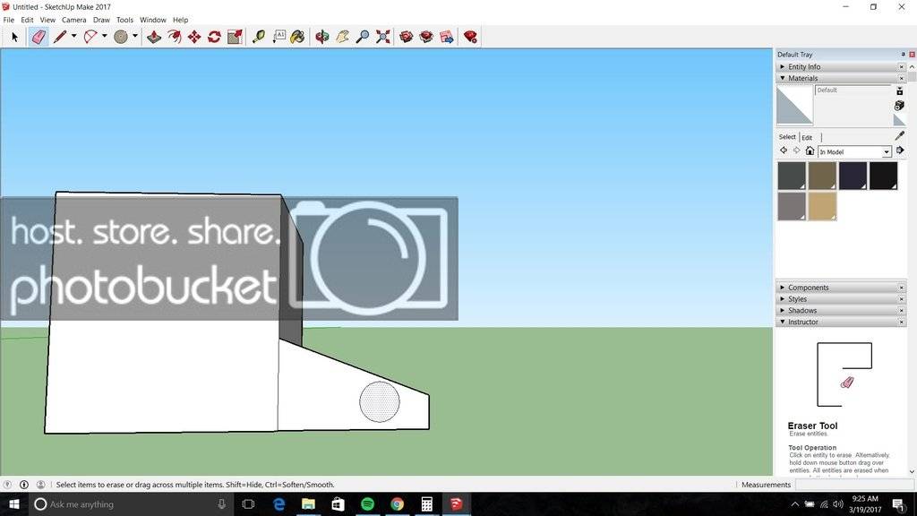

15X15X15 was already stretching it so adding a half inch isnt really possible. To get the extra room I can bump the bottom of the box out. I am trying to learn sketchup but I have a long way to go but I would do something like this. That is not even close to scale btw.
"][/url]
How about top port mostly external but the roof is close to the roof to load off the roof
I am sure you are leading me in the best direction possible to get the most out of my stereo but I really need a compromise between bumping and having a family and "normal" truck. I am trying to keep it as low profile as possible.
