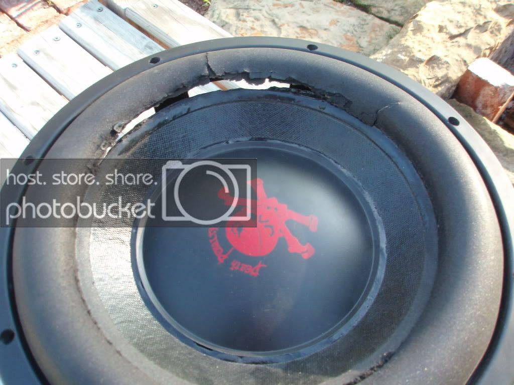

Well as you may know I recieved a 12" DP a few months ago and the surround crapped out on me so I got a recone from IA. I just ripped everything out today and won't be starting anything like cleaning the gap or the landings until tomorrow, but at least I got the ball rolling on this. One thing I noticed about the original soft parts and the recone was that the original former (from the bottom of the spiders to the tip of the coil) is about 1/8" longer than on the recone I just got... Will this allow for me suspension travel?

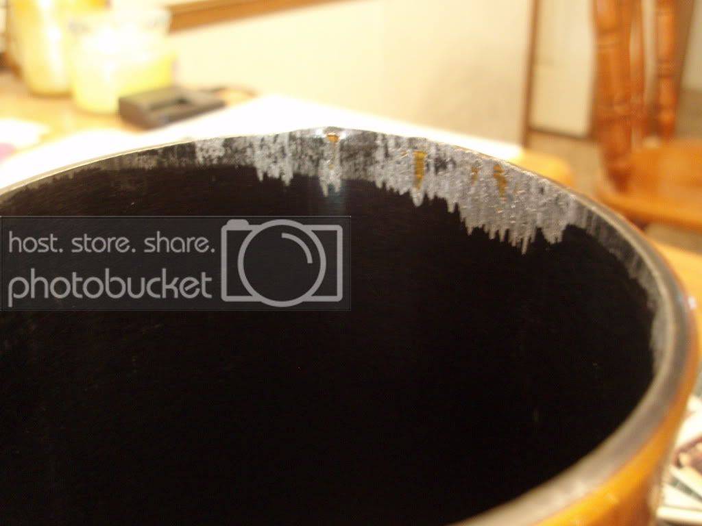

Also, as you will notice in the last picture, because of the surround being torn, the former was rubbing on the pole vent and actually rubbed through the former in one small spot, and the pole vent is scratched up a little, but will this affect anything?
any suggestions on material to remove the surround/glue? I ended up using a scotchbrite pad bit + air compressor, it worked out really good but I did go through 3 scotchbrite pads, and 3 sanding disc's for the spider.
Acetone works well.
I thought DP's came with triple spiders?I think I see a forth in there though.Or is it just me....
My DP did come with 4 spiders. I'm thinking this wasn't a normal sub "off the line sub" when I took it out and noticed the former was longer than the new one, it had 4 spiders, the coil was already discolored(light colored), and the surround had a small scuff in it when I first got it (didn't affect the tearing you see in the pictures, but it's like it had already been used some for testing). Now I'm not sure how many spiders the new cone had, but it's not as thick as the old spiders so I'm guessing this one only has three after what you just said.
