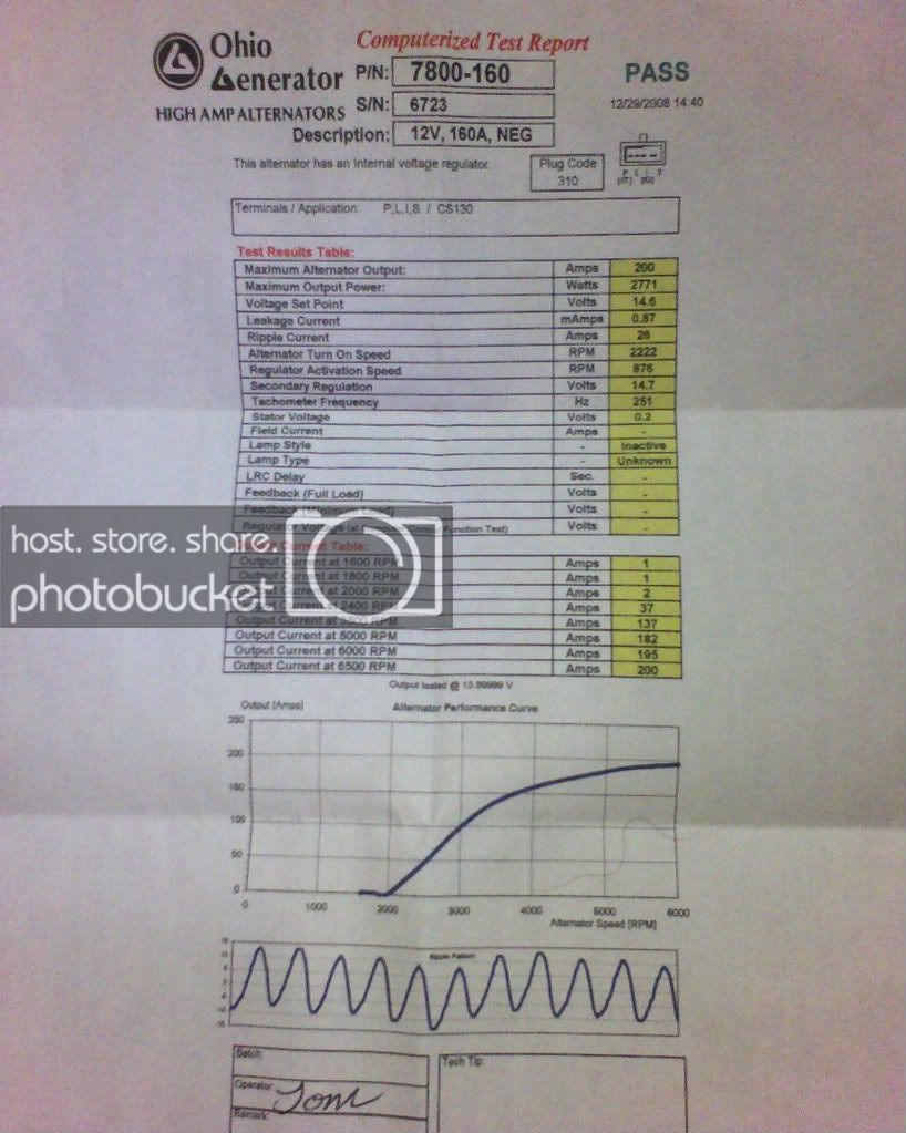

So yesterday I was looking into finally getting a HO alt for my buick century. Someone brought up Ohio gen and so I gave them a ring. They built my alternator in only a few hours, which was enough time for me to make the hour and a half trip out to Louisville. Anyways, the alternator is a CS130, which fits directly were my current alt is. The specs from the test sheet are as follows:
Max output: 200a
Max out power: 2771 watts
volt set point: 14.6v
Leakage current: .87mA
Ripple current: 26a
Turn on speed: 2222 rpm
Regulator activation: 876 rpm
Secondary regulation: 14.7v
Tach freq: 251Hz
Stator voltage:.2
Output at RPM:
2400rpm-37a
3500rpm-137a
5000rpm-182a
6000rpm-195a
6500rpm-200a -Max

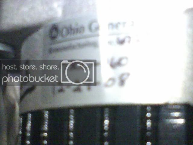

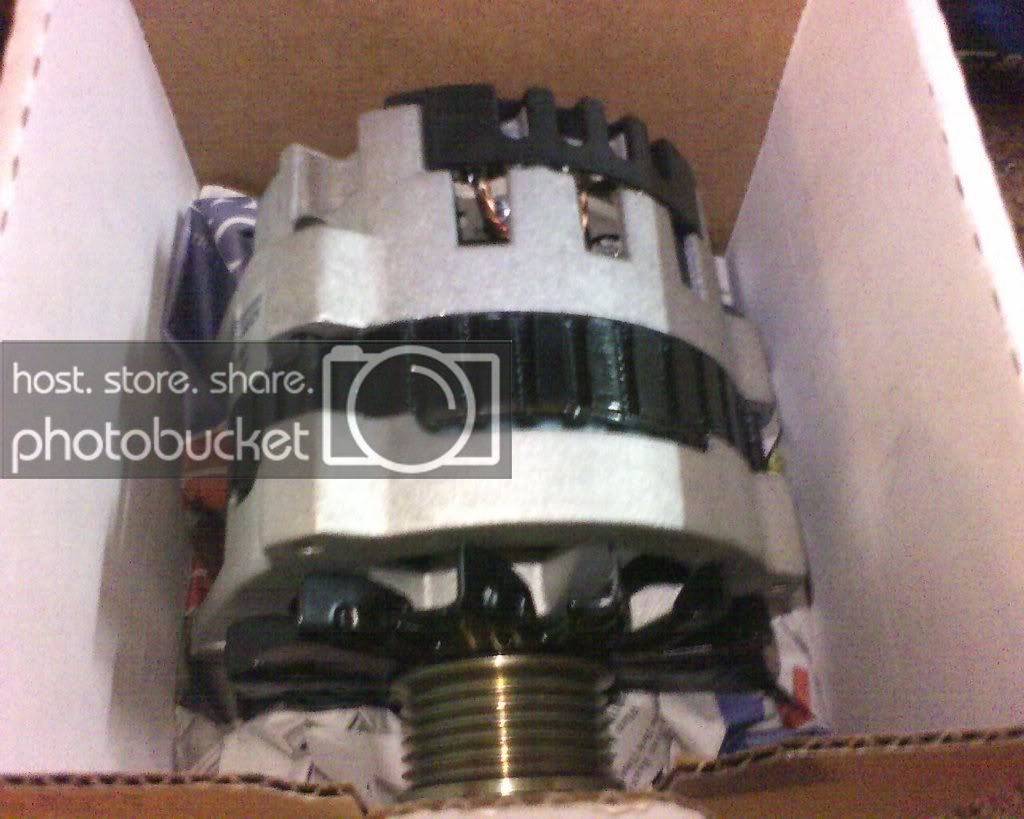

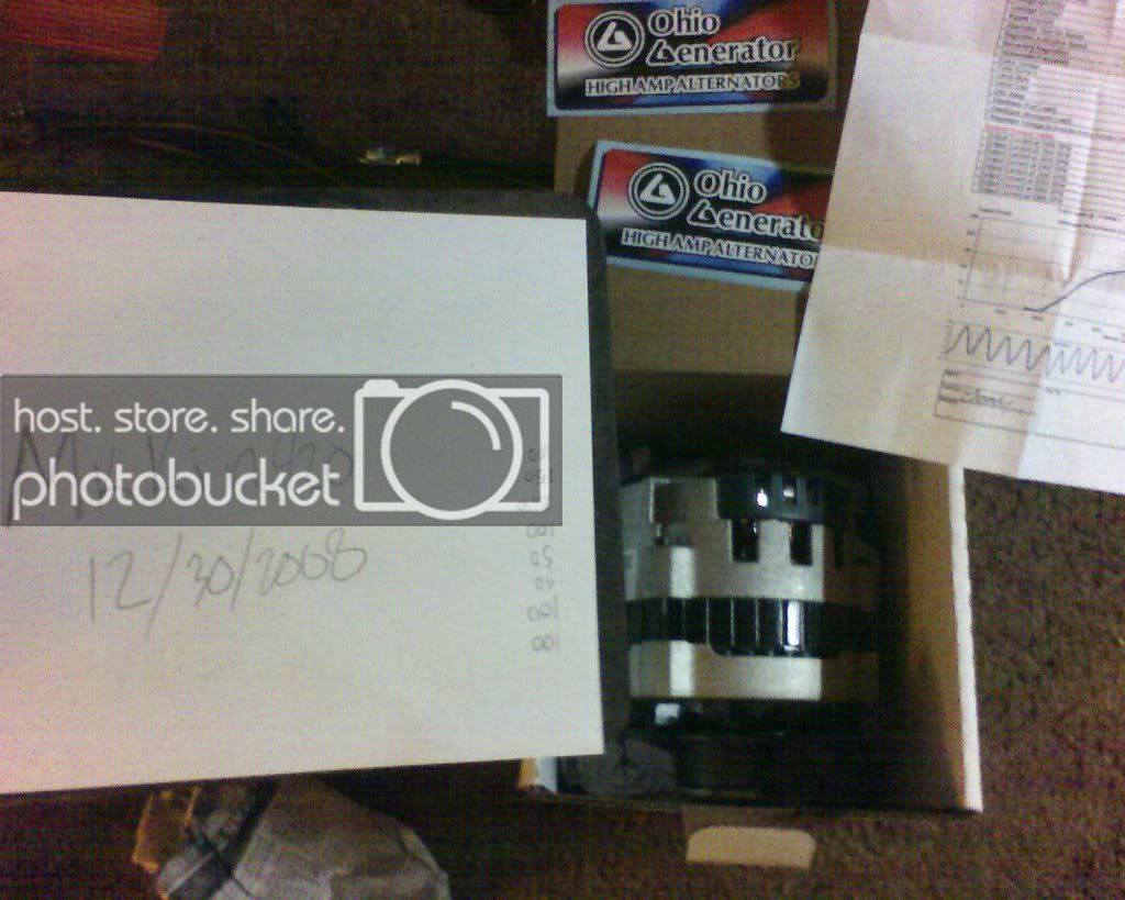

Alright so I took some pics and here they are:
