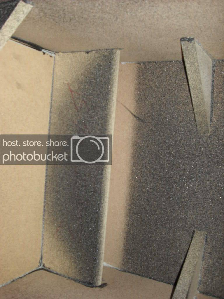

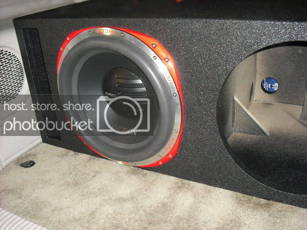

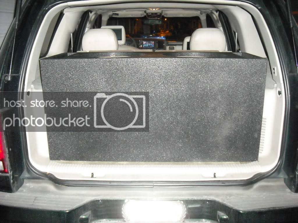

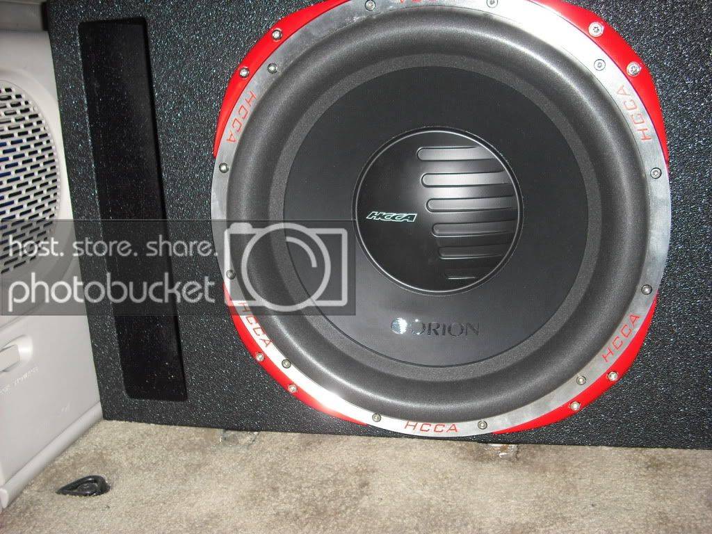

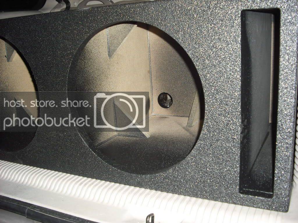

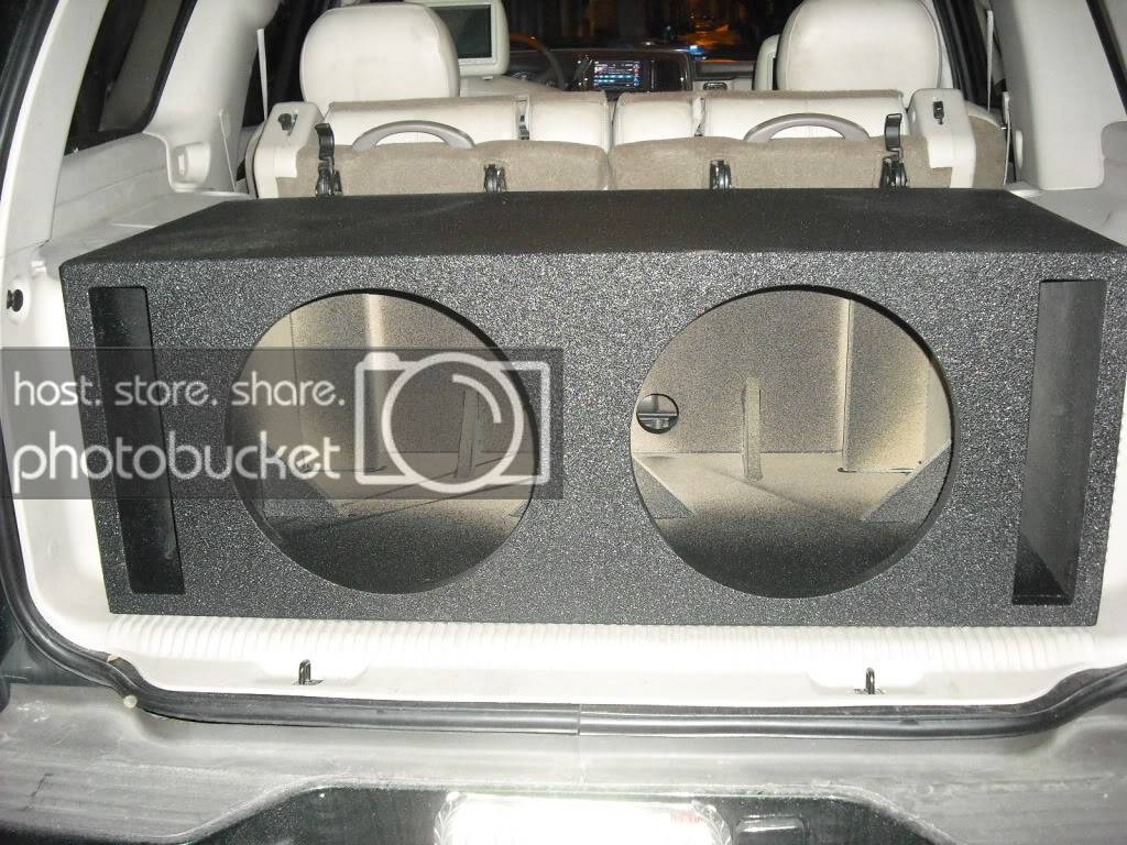

Ok so here it is. Ported dual chamber and done with 1"MDF all around. then finished with 5 layers of lineX. I dont have the specs with me but this thing is massive and is oversized to fit the HCCA 15.2s. Each chamber built to spec and ports Tuned to 29 and some odd Htz. **** thing sparkles in the sun! lol. well im happy with it and so far the one HCCA paired with a HCCA D5000, Iraggi 300 and Kinetik 2400 sounds insane!! Cant wait to pop in the other sub and batt. Tell me what you guys think since im finding im really not too fond of the wedge bracing and terminal cut out.
Is the motor supported inside by those triangles ? If not I would really suggest something under the motor if those will be firing backwards. HEAVY drivers.
i know. thats what i was thinking first time i picked up the sub. but how would i measure the exact spot where the motor rest?
ehh 1 layer of 1" for 75lb drivers mounted on there side? bad call.. also .. i see a brace sitting horrizontal to the port right in front of it .. thats a no no
hmm ok what do i know? //content.invisioncic.com/y282845/emoticons/eyebrow.gif.fe2c18d8720fe8c7eaed347b21ea05a5.gif
i lol'd
the liner looks awesome, i dont like the bracing either though, i feel like thats pretty inefficient seeing most of the flex is going to occur at the center of each board, not at the joints...
I didn't mean to sound confrontational, man.
I was just saying that I think it'll be structurally sound, because 1" mdf is pretty stout.
I don't really think the bracing is too close to the port either.
The OP will find out for himself...
