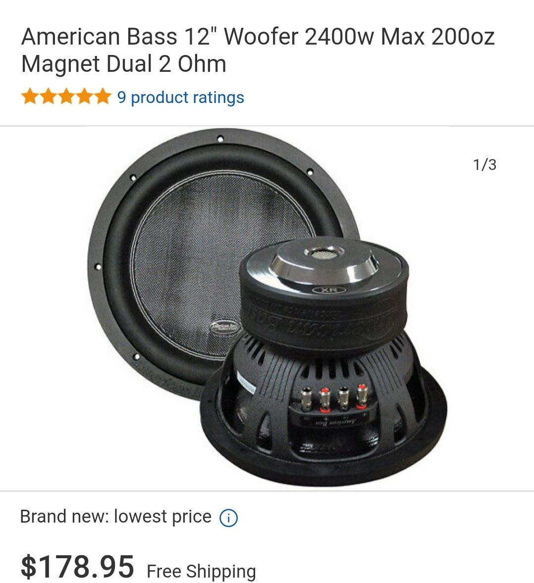

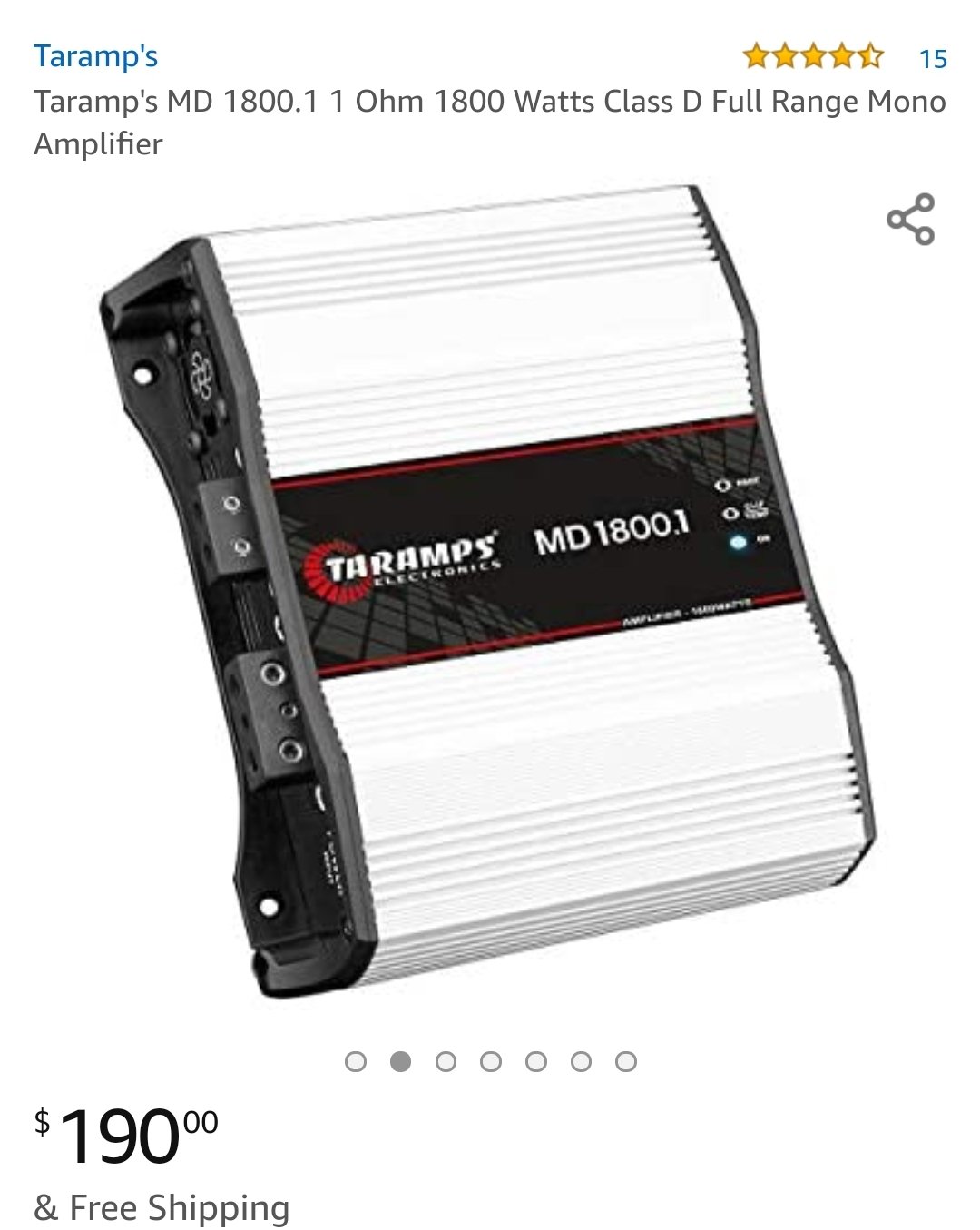

These should work for you! Taramps MD1800
1 and American Bass XR12d2. If saving space, then, a Dayton 12" in a sealed box.
