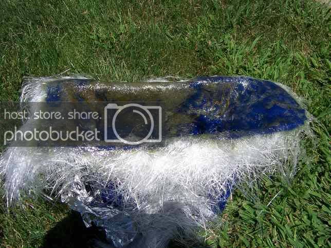

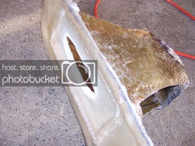

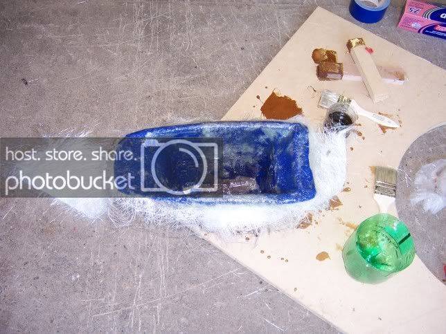

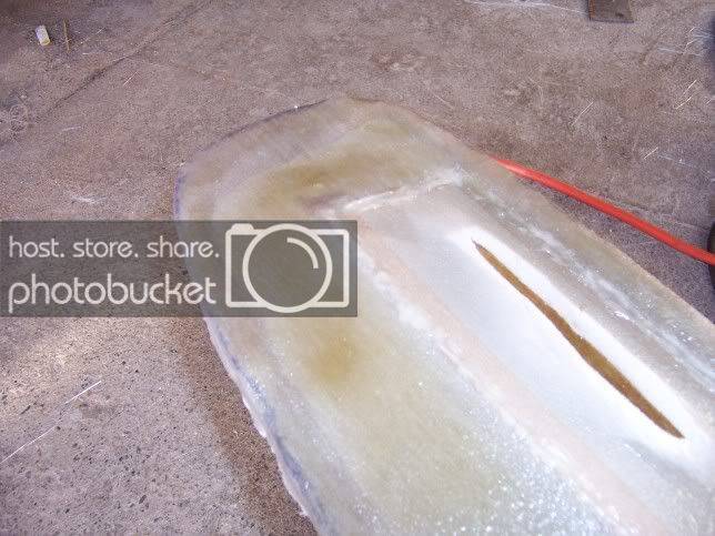

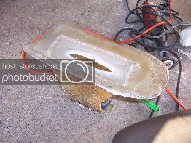

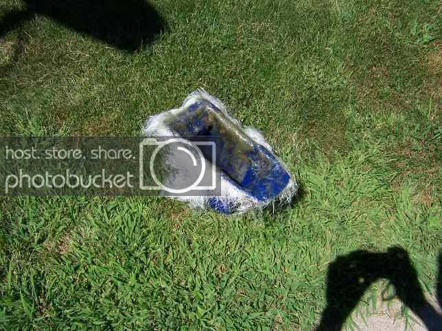

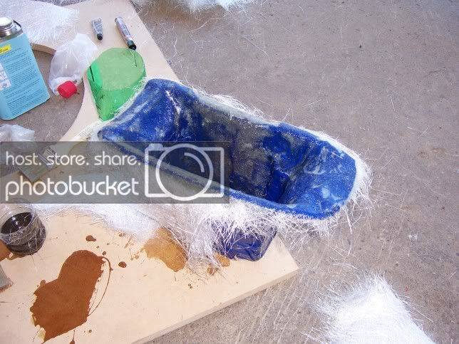

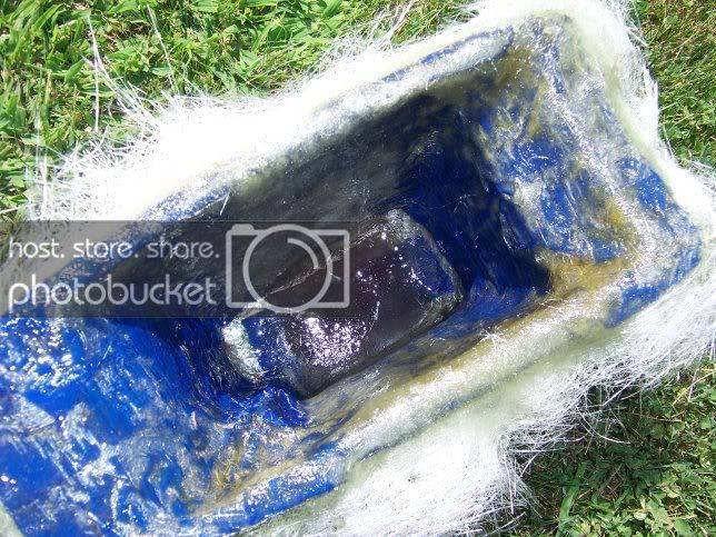

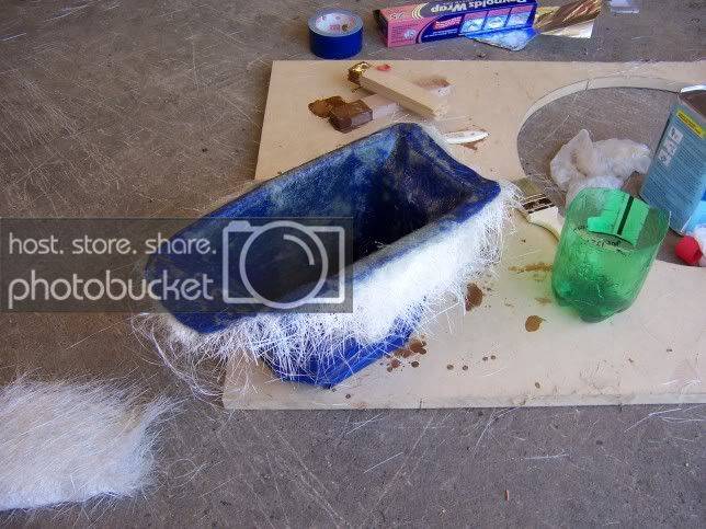

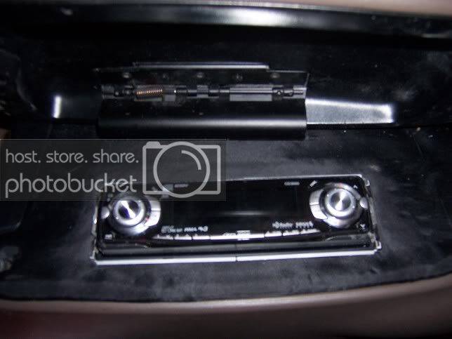

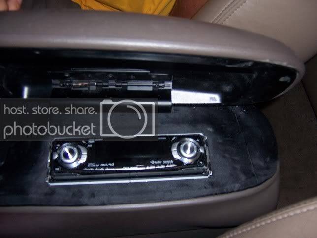

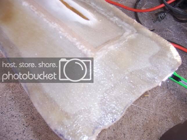

Started this about a day ago after work for my buddy. Hes got a 99 Mercury Sable, he wanted to put the headunit in the center console to hide it, and also so anyone going around here looking to rob someone wont see it. Its basically finished, I didnt get a ton of pics of all the work but some of the basics, Im going to re-wrap it tommorow with another material and do a litte trimming, the material we used is like a silk type fabric but I didnt really care for it. Tell me what you think about it, and any tips or advise you might have.
Drill some holes in it to add ventilation? Might want to.
Yeah thats really the only thing I was worried about, the actual fiberglass part is completely cut out at the sides, but the console part only has about a 1 inch hole towards the bottom for wiring. Ill find out tommorow if he had any overheating problems. //content.invisioncic.com/y282845/emoticons/biggrin.gif.d71a5d36fcbab170f2364c9f2e3946cb.gif
