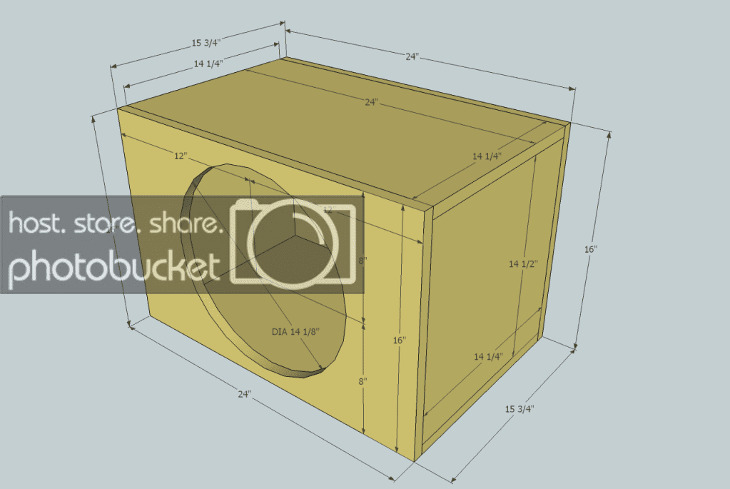

FI Q 15 sealed box size?
its mainly power handling, you can throw more power on a smaller box. Just cram some polyfill in there and you'd be fine with the 2500 bd cp on it. Make it 2.5 cubic feet man, 2 cubes tiny for a 15. Make sure you have bracing and account for subwoofer/bracing displacement too.
I may try running it at 1 ohm but I had a Q before on 1000 watts only and they sound great. I only have one battery up front so I'm trying to make it as efficient as possible running it at 4 ohms
I believe that's the old Q.. but the new Q is pretty power hungry because it's been beefed up.. that's why its rated at 1500.. go with the larger box.. trust.. you won't regret it... I have a 12" Fi Q ported and it barely gets going at 1000w.. Go with 1 ohm for sure
Ok thanks for the replies guys, I have the 2500 bdcp it puts out at least 1500w at 4ohms. The birth sheet is showing just over 2,000w at 14 volts. Should I still wire to 1 ohm?
You are not powering the amp on a test bench or running a resistor, or playing it as high as they do to get that misleading number. It will do rated 1500 daily
