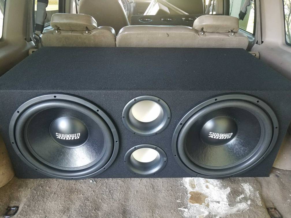

JVC HU, Pioneer 8601, 2 sundown e 15 v3's 5.8 cf ad ported tuned at 34hz

Yahhyahh....build a box for those e15s bro. I had 4 in brothers explorer and on 2k neigbor said I was shaking his windows. It 95% in the box. 2000$ on amps subs and Alta and batts or 200$ on wood......or 300$ for someone to build one

you have anymore space? you are killing them 15s with only 6 cubes. you need at least 8..
This current box I should be getting a new box within the next month or 2 I'm trying to sell my ps4 then I could get me a box made he says 350 for a box tuned 32 hertz and with 8 cf
Sundown E-15 v3 5.8 CF Ported @34hz on PPI ICE2600

I was thinking dual 18s but I think I will just get me a custom box made for the ev3 15s and see if that's enough everyone says all I need is a better box and I won't be thinking about more subs
