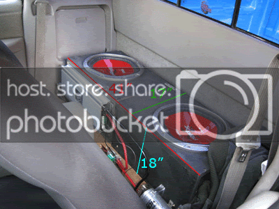

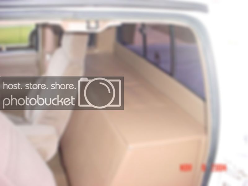

This is what I have to work with for room, and still be able to have some seat room.
Mainly what I’m looking for is good bass for everyday listening, mainly rap, and some rock. What would anyone recommend? I have all the materials & tools to build the box, mostly just need to figure out specs on it.
