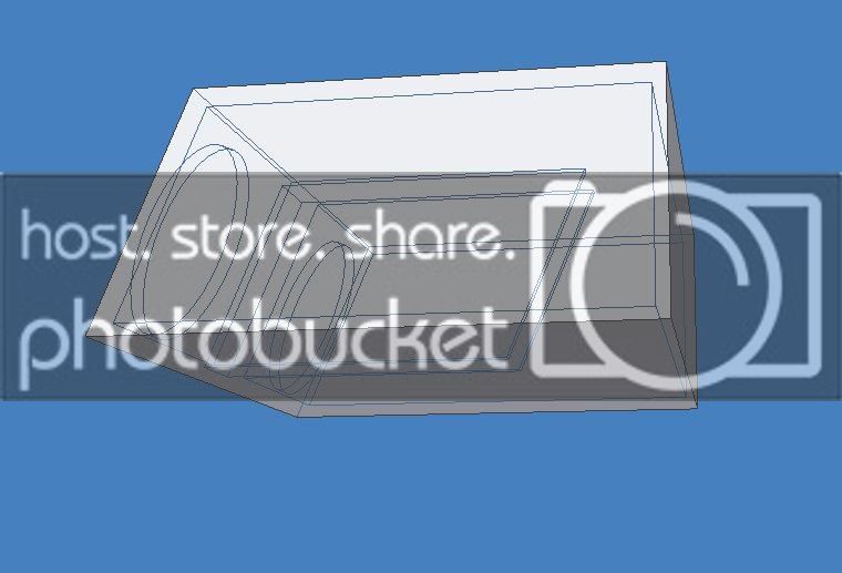

Ive never seen someone do this so Im not sure it would work out like I think it would, but what do you think of this port setup? If this wouldnt work out properly please explain why cuz I cant see how it wouldnt.
lots of people use that, it would work out fine.
Alright cool, thats what I figured I just wasnt sure if it would still work out the same.
Kinda hard to say it would or wouldnt without the speaker specs, box dimensions, port dimensions...... etc
Wasnt really asking that just the general idea of the port setup, but thanks for commenting anyway;)
Thanks again guys!
I think the port should be square with the back wall.
my .02 no science, just my gut.
I usually see the subs/ports on the FLAT wall.
No, then there would be a port area change b/w the front opening and the rear opening which would in turn affect tuning...it would be inaudible really but for whats its worth, the slanted rear end would be correct.
sure, I still say take 'em out the flat side. I hate having to deal with that angled crap.
OO, I think I see what your saying. Are you suggesting running the port parallel to the back wall instead of the way he has pictured? I totally agree that I hate dealing with the angles crap in building and designin, lol.
Yeah angles are a bitch, but Im going to be sealing my trunk off so I need to angle it:up2somet:
Wait....whats going to happen to your Ava??? Or is this for another car? That install is nice already...
I sold it:D Now I can use all the power I have with my MD2, Ill be running rough 1800wrms to two 12" RL-Ps. Ill have thread with pics and vids of course;)
