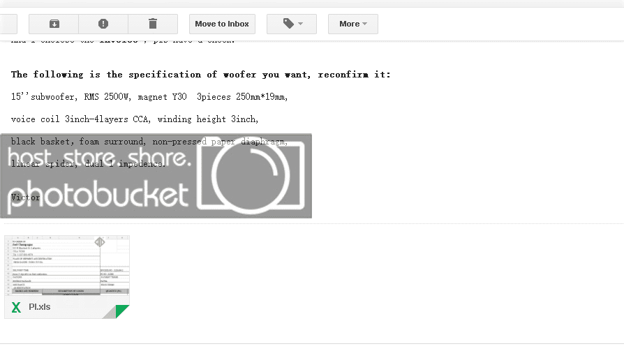

here is the initial email. this is the salesman. they got the basic design i wanted to get a order processed. i talked for about 2 weeks between the sales man and engineer through a chat app. as he started to model the driver i mad suggestions he modeled it and we made changes.
initially i wanted a 75mm coil with a 32mm top-plate but the after modeling the driver i decided that we could step up up the wire gauge on the coil still get meet the inductance but of course b/l would drop so we went with stronger magnets and a larger top-plate to bring the B/L up enough to compensate for the decreased L.

The coil is custom would. The topplate and t yoke aren't standard on any platform you can order from them.
Call the yourself and see. .
Everything else is standard parts whish are fine no need for custom spiders. Although I do want a better basket the ti basket ***** for the cooling system im using which is again pretty much industry standard..
So what they did is used a program to model up the driver to try to get it close to production. Built a driver and then sent it to me. I made revisions and rebuilt the driver.
It wasn't anything stock about the motor it took two weeks to get tge coil and tge ******* because I had them modify it again. Lol
You say it's stock parts but I've yet to see a driver similar in build or spec.
A topplate is just a metal with a thickness OD and ID.
When I say custom I don't mean exotic I mean I had a certain build philosophy in mind. Nothing they offered match so they agreeded to do something unique.
Its that simple. How ever you want to put it i dont care.
I wanted a long 4 layer coil to lower inductance and maximize thermal transfer from the higher surface area vs the typical much Smaller gap and shorter 8 layer coil.
I also wanted the to pay special attention to the inductance but by design the coil offers lower inductance.
