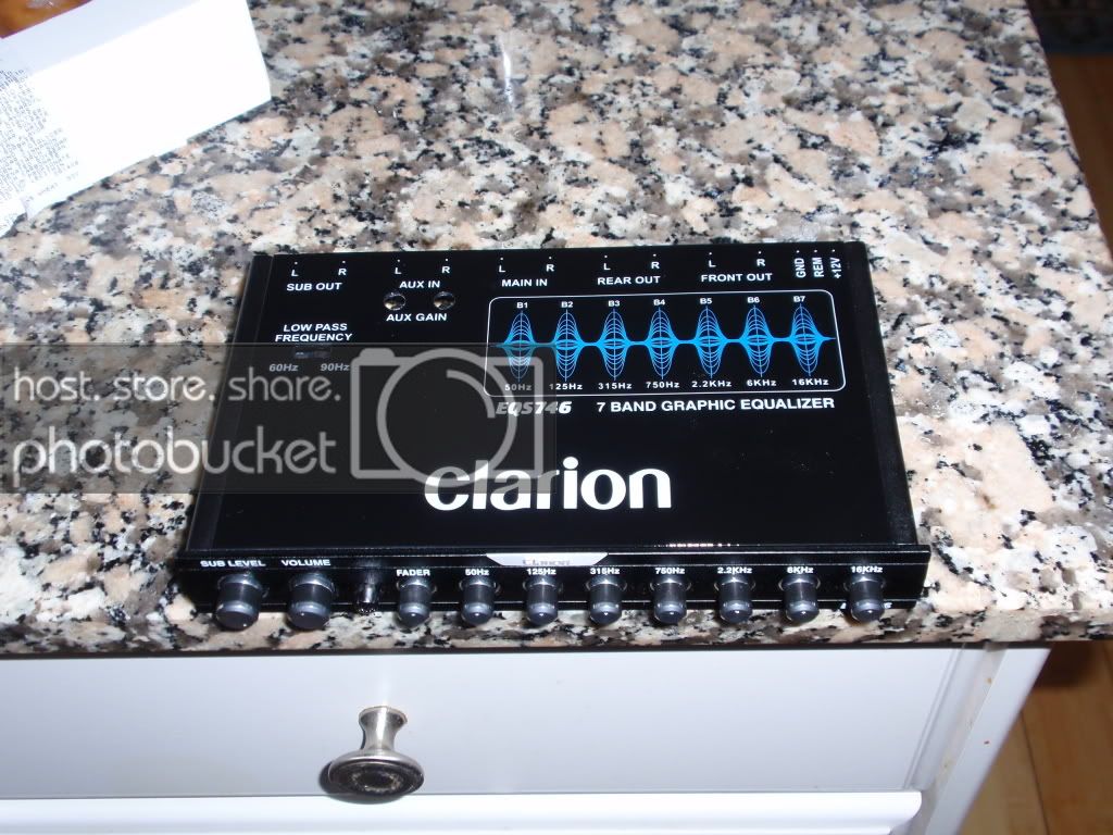

you'll need a quality equalizer dont get junk
clarion eqs 746 and an Auxillary(3.5mm) to two RCA Y-cable.
Just plug the RCAs into the aux section, hook everything else up, and play something and set the aux gain afterwards.
THATS the cheap one. The good one is an audiocontrol LCI 6
