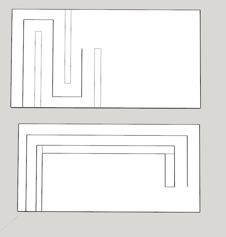

What's the most common method of port design in your typical "L" shaped box when the port is longer than the box allows?
Here's two different styles i've seen, (rough sketched this to show you what i'm talking about)
2nd 1 is easier if u round corners and if u use 3 sides of the box like that u can subtract 1/2 width of port from length... labyrinth would need 8 corner boards just more work.. don't know if 1 is really better..
