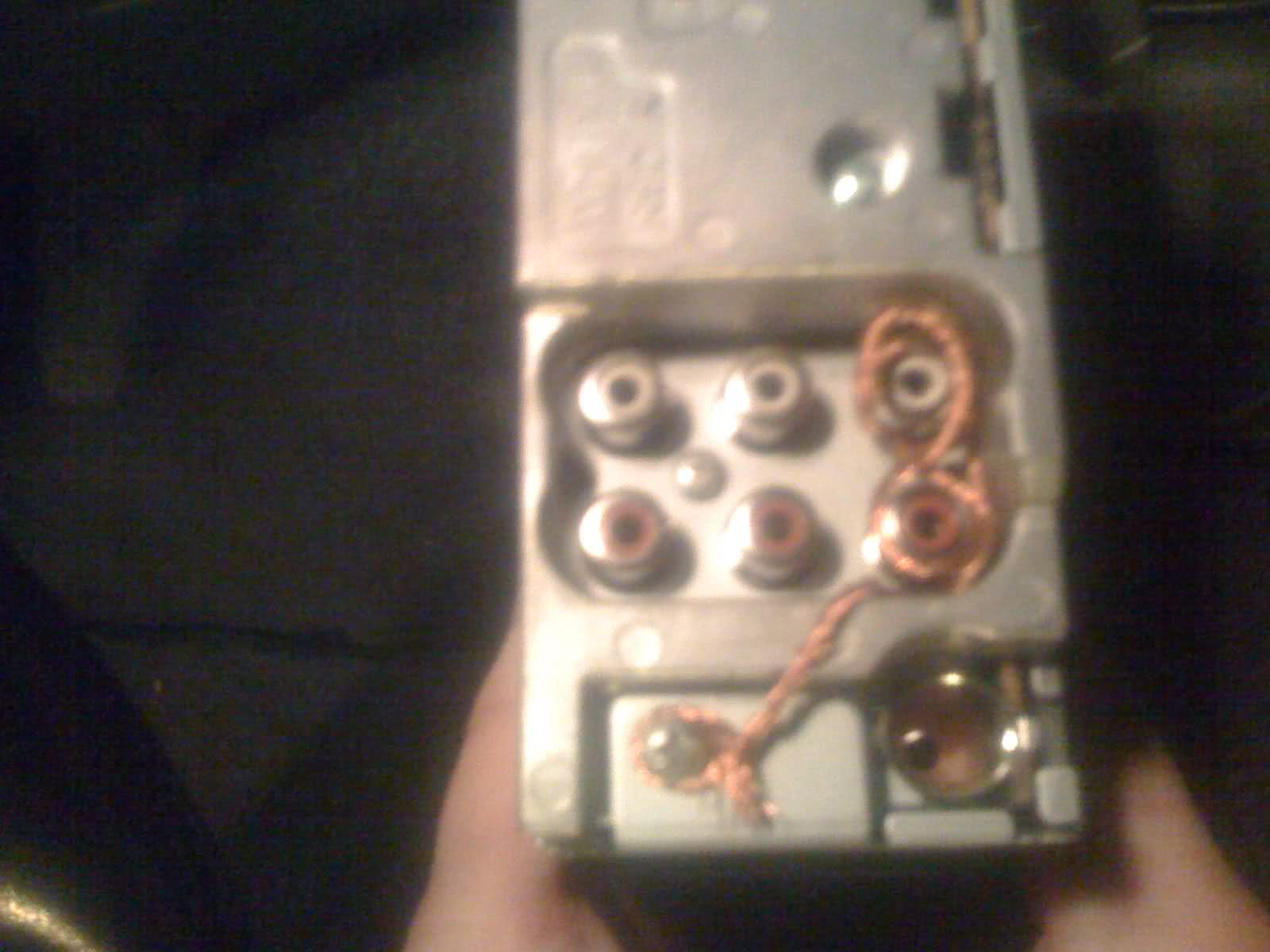

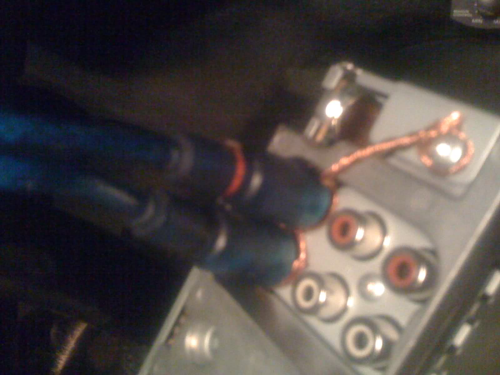

i have pioneer 4900. i tried everything. moved rca on opisite side of power wire. moved amp 20 times. moved ground wire to amp to chas under car. tried bolting ground wire to frame and running to headunit.
nothing worked. the sound just drove me crazy. when your idle its at its loudest. i just couldnt take it anymore. i found this site, and i was like ill give it a try. and it works!!! omg thanks so much. i couldnt beleave pioneer havent fixed this. this will be my last pioneer...sad, i really like the radio. wish they would fix it, or do recalls and fix it for free. but thanks so much.
heres what i did, hope it helps someone see.

I had this same problem with my newly installed (Non PIONEER/PANASONIC H/U) system. (1000w Pyramid amplifier, 2 12" Pioneers, AIWA CDC-Z127) The high whining noise got very annoying! So today I decided to rip everything apart and rewire some stuff. I noticed the guy who installed my system wired the RCA and power cables both on the same side (passenger side). After rerouting both cables separately (One on each side) and grounding the RCA shields to the stereo chasis like the first couple posts show it fixed everything. No more whining noise, no more hissing/popping. Only thing I can see wrong now is that it isn't loud enough. It should be rattling my mirrors a lot more then it is. I have to turn my deck all the way to about 68 before it starts to hit really hard and the stereo only goes up to 80. My roomates starts hitting at 5. Whats up with that? lol Gonna slap in a new deck soon anyway. Cheers!
