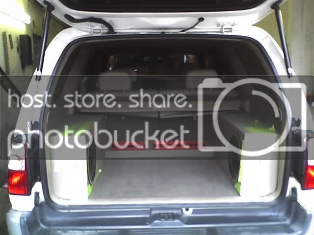

Here's an example from a 4runner I did... the green tape is just holding the trim panels on while the adhesive dries. Setup sounded great!
