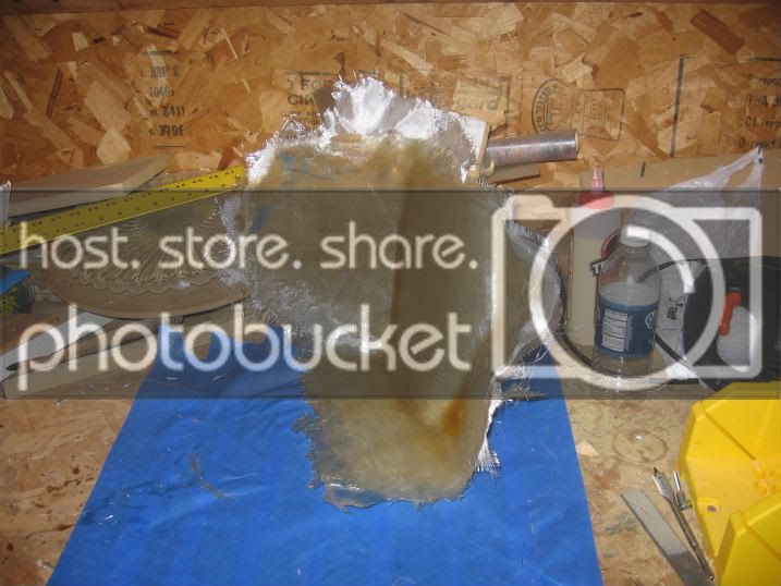

This is the driver's side kick. It's not cut yet. You can see how flimsy it is with only 2 layers. Yes I know there's a little hole in it, I'll get that patched. This was my first attempt ever at glassing.

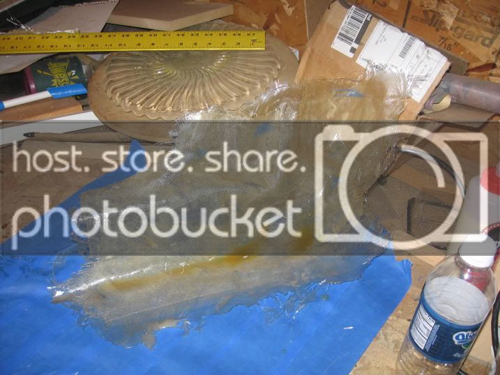

This is the passengers side. It has 5 layers, more in some parts. You can see how big it's going to be at the top. I plan on making the top part big enough to give it some good internal volume, and it will still be somewhat unobtrusive.
