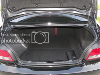

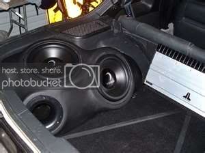

Would like your opinions on how I could best incorporate my current (2) JL-6w3v3's into a 'ported' fiberglass enclosure (on one side) and also a 'sealed' enclosure with either a 10w6 or 12w6 on the other side. First off, SQ wise how would this sound? I do like the "punch" that the 6's have so I would like to incorporate them with the 'lower range' that a 10 or 12w6 would bring. I know that by placing them on separate sides of the cargo area I would need to watch for "cancellation" but, if they were aimed properly they would sound good together...amirite?
Couple pics of enclosure designs that I had in mind...
Something like this on the left side of my cargo area for the 6w3v3's
or this
With something like this on the opposite side...

That's because it's not true. All it takes is a different method for figuring out internal volume. You most certainly can port a fiber glassed enclosure. I would use an aero port to simplify your install.

even your second picture shows a ported fiberglass enclosure
Yes, That's why I picked that one out...And, I would be having these built for me(at one of the local dealers) No way in hell I would try that myself.
