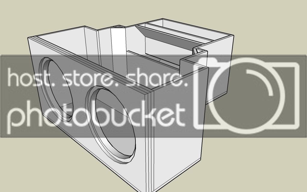

^Yea I was thinking that...and at the front/widest point it'd be 48.5" wide..

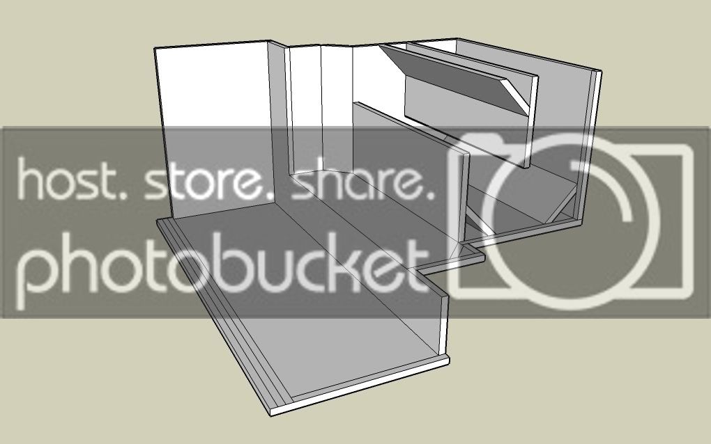

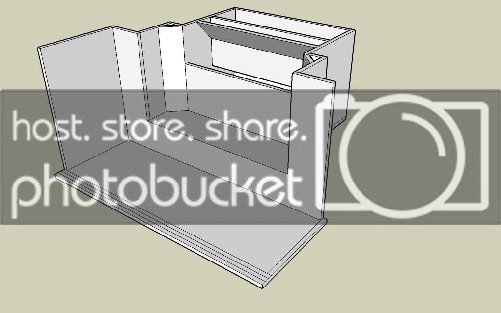

Here's what ive came up with..
Specs:
12.308 cubes net
30.25 Hz tuning
202.5 sq inches of port
(I think it's safe to say the lows will be taken care of //content.invisioncic.com/y282845/emoticons/smile.gif.1ebc41e1811405b213edfc4622c41e27.gif )
Some of the walls that are single layered will have supports and/or a thick fiberglassing on the inside and also the top of the enclosure on the outside will have a nice, thick layer of fiberglass on it for some strength (and most likely resined throughout the inside to smooth everything and make sure it's nice and sealed...adding mat where some added strength is needed)
sexyness //content.invisioncic.com/y282845/emoticons/fyi.gif.9f1f679348da7204ce960cfc74bca8e0.gif that looks pretty intense to build and should dominate the lows. cant wait to see this
Thanks, the rear window will be removed for this install so that will thankfully be out of the way...with it there it'd be extremely difficult working around it. But still it'll be a fairly tough build with almost everything being built in the enclosure...plus a large amount of fiberglassing will be going on inside and out of the enclosure (along with the front doors having pods fiberglassed into each with a pair of 6.5" comps in each door, a buddy whose really into fiberglassing will hopefully be able to do that for me, should be sick)
The rear deck is pretty much going to be gone too, cut away...but if it's structural the enclosure will be bolted at multiple points on each side of the enclosure so that'll hopefully make up for it.
