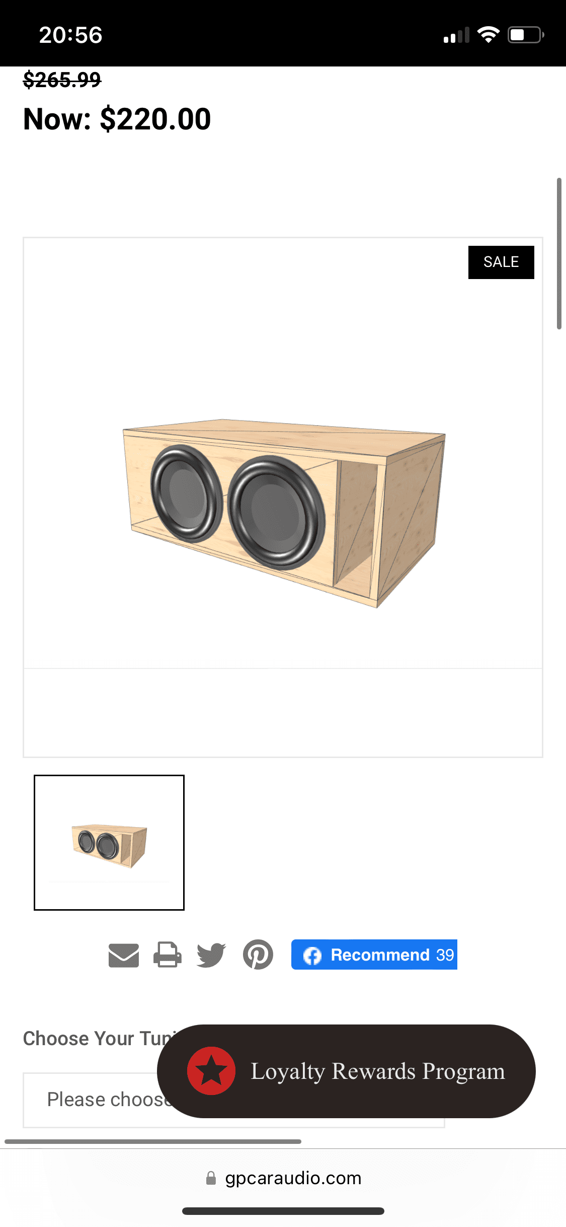

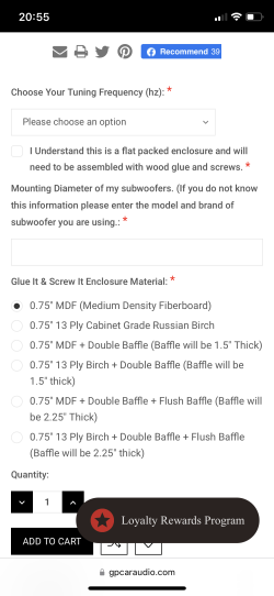

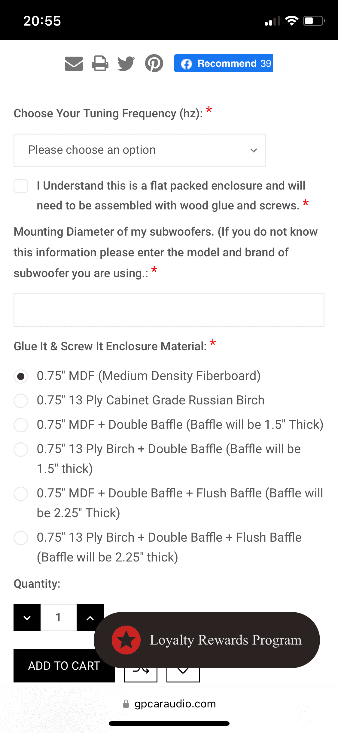

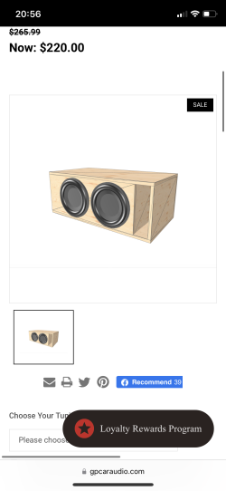

Could someone help me choose the tuning and material of this enclosure? The tuning options are 29-37hz
The subs I have are 12” Skar SDR’s. Amp is a Skar 1500.1D

Materials, I'd say 3/4 mdf or a high quality void free plywood. Double up the baffle and/or brace the baffle. I'd say minimum ~1.75cuft (as does Skar). Tuning depends on what you're trying to accomplish. As low as 30hz and maybe as high as 45hz.
