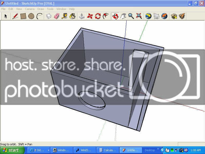

I am thinking about getting a new sealed enclosure for a single 10 inch Alpine Type R. My goals for this enclosure are based on my personal tastes in the total sound experience, which are probably different from many.
I listen to many types of music, but the most important genre to me for the purpose of this project is bass music. I have been listening to bass on a variety of different setups since the days of techmaster p.e.b.
Before describing what i am trying to accomplish, let me start by explaining that I understand I am not using what many would consider the optimal driver for obtaining very low frequencies such as those below 20Hz. I understand the limitations of cone area and the direct relationship between that and movement of air. However, I am still attempting to meet my goal so...
What I am trying to accomplish from this enclosure:
1. Having something unique that suits my personal interests.
2. Using the 10 inch Type R driver in a sealed enclosure.
3. Tuning in the lowest of frequencies as much as possible. I love the lowest note on Bass I Love You, and actually can hear it decently well with my current box, with the left-side back seat in the down position. I do want more if possible.
4. Audio system is commonly used with engine off, windows cracked for best frequency response. I do not necessarily listen to this system very loud, although I am still getting alot of rattling inside the cabin.
Here is what I came up with.
1. Large box to allow the most unrestricted cone excursion, therefore propogating the cleanest possible low frequency sound waves for this sub..
External Dimensions:
H - 13.0 in
W - 15.0 in
L - 24.0 in
Assuming 3/4 inch MDF, that would give me approx 2.8 cubic feet if i calculated right.
Please post a response telling me what you think, and if there is anything I should know about accomplishing this goal of trying to go as low as possible. Am I on the right track or am I somewhere out in left field wandering aimlessly.
Thanks in advance.
Just to put you up on game...
... There is NO tuning for a sealed enclosure.
Only thing you can do with a sealed enclosure for that sub is make it around 1.5cuft and include about 50% polyfill.
... or go with a ported enclosure tuned @ 40hz ( 38hz at the lowest )
Thank you for taking the time to respond, and perhaps you are correct.
But... once again everything i understand about physics and the laws of motion suggest that the volume of air behind a subwoofer would change quite a few parameters that would directly effect the overall performance characteristics of the driver.
My main concern would be air pressure behind the subwoofer. When the speaker is moving quickly at higher frequencies, higher pressure behind would seemingly assist the cone in returning to its point of origin, which is good when trying to oscilate a reasonably massive object very rapidly.
I however, am going to need some extra excursion, (remember, I am going for 25hz and below) causing a need for the cone to move more freely without overloading the the electromagnetic system.
I am hoping for some more responses to help verify what i am trying to do.
Well... First off... 25hz w/ a 10" Type ARRHHHH ????? That's goin' to be a VERY faint note.
2nd: you're not goin' to achieve more excursion in a sealed box.
* Being sealed = tighter bass, stiffer sub... It doesn't give your sub any time to move. ( Like you're wanting it to )
3rd: you need a ported enclosure...
You want to be careful about putting that 10" in such a large enclosure. The air inside the box acts as a restoring force (hence the term acoustic suspension) and if you have too much air to compress then you lose that restoring force. My recommendation for you is to download WinISD, learn to use it and play with enclosure designs. You are probably going to be pointed in the direction of a low tuned ported enclosure. This will emphasize the very lows ( I like them too). Good luck!
This is what you need
... 2.08cuft Overall - tuned @ 38hz.
20"W x 15"D x 12"H
Nissan, I have just done some quick research. I believe I am correct with my theory on internal volume affecting cone backpressure during excursion, and subsequently the overall frequency response curve of the subwoofer. (If we consider the JL Audio website scientifically sound.) While I will agree with you that there is "less" tuning involved with a sealed enclosure, there is still "some" tuning that can be done, and can be compounded by greater differences in air volume behind the cone. See: infinite baffle.
Also, I would absolutely love to do a ported enclosure guys, but once again, I am really trying to reproduce these low frequencies. Im dealing with very long wavelengths, and to be honest, it would be difficult to create an enclosure that would house vents equaling the quarter lengths of these waves.
To be honest, I would love to try a transmission line box, but I lack the woodworking skill/tooling to do so, and I really do not know where to go or who to approach on that one.
And yes, I did mention above that what I trying to do with what I have is challenging/counterintuitive, but maybe what I learn from this can later to be applied to "bigger" and "badder" subwoofers. I guess you could say I am starting out on a small scale.
Thanks for you honest concern guys.//content.invisioncic.com/y282845/emoticons/smile.gif.1ebc41e1811405b213edfc4622c41e27.gif And yes Tez, I am seemingly dead set on using this sub. (See reason in my last post). I realize that there are some limits, and the bar is not set very high. However, it is not permanent, as I will undoubtedly suffer from the "its never enough" syndrome and apply what I have learned to bigger and better things.
GLN - I certainly will try the software that you suggested. I have actually worked with some lesser versions of enclosure software, and have learned a few things already. Very valuable stuff.
I'm not telling you not to use the type r... I'm just simply stating.. go ported.
... I calculated...
(1) 10" Alpine Type R in a 20cuft. enclosure SEALED ( WOW! )... would be 30.88hz capable.
... Have fun with that.
