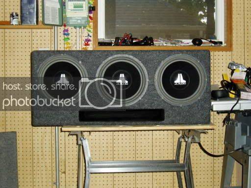

A friend of mine wants an enclosure built for his 3 10w6ae.
For his space requirements, I came up with a ported enclosure that is roughly 3 cubes net. Two 4" round ports at 20" each.
I really don't know about these subs, never heard them.
JL recommends 1 cube each ported and .625 sealed for each of these. If Anyone has any experience with these or could help me out with this enclosure that would be great.
Here is the enclosure
I'm about to install 3 of them in my car (reg orig 10W6 not AE but other than cosmetics, they are the same sub). I had 6 of them at one point. They sound great and get really low with .7 cf per driver (f3 of 40hz and will play flat to below 10hz in car). I haven't used them ported. They should sound good with that box. Better than the JL rec. box. Less boomy. You could even lengthen the ports a bit if you wanted to for better low end extension.
