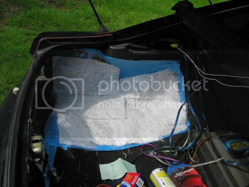

Started off by lining my trunk with blue painter's tape and wax paper, to make sure that no resin finds its way to my carpet... and test fitted the fiberglass i had leftover from a bumper project... just the right amount with a lil extra!

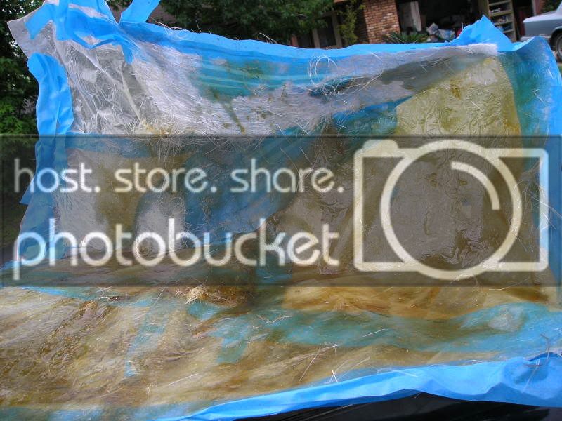

So i put a layer of resin down to sturdy the box enough to move in and out of the car, and mid-way through the resin and first layer of glass, i realized my brush was hardening, which made it impossible for me to finish the first layer of glass.... Shit...//content.invisioncic.com/y282845/emoticons/verymad.gif.3f39c5c2fd57527b671fad3efdfac756.gif so i was left with this..
Its not all bad, i just need a roll of chop mat and might as well pick up some more resin while im out... and an assload of cheap paint brushes...

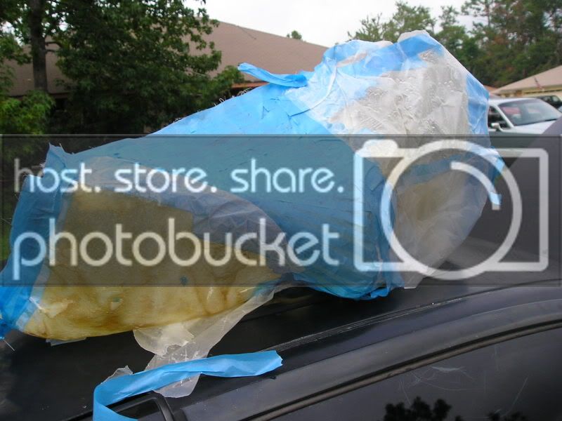

no actually i need to spray a couple panels with 3M Super 77 because as it was curing i was trying to hold the blue taped part up against the interior so it would cure in the right shape, and underestimated the exothermic reaction the resin goes through so it got too hot to touch and sagged there a lil bit... but other than that theres only like 1 or 2 places that need care... otherswise the box is fairly sturdy... only 1 or 2 places actually flexed at all when i took it out this morning. Also, i didnt realize how much of a ***** it was gonna be to put resin on the vetical or overhanging pieces... i wonder if i could use a spray bottle? have any of you ever heard of that? And when i fasten the fleecing material to the box, what do i do about overhanging pieces of fleece? and do i fasten the fleece to the outside or inside edge of the box? I'd like to do it inside if i could because if i add any to the outside edge im afraid it wont fir back in there...

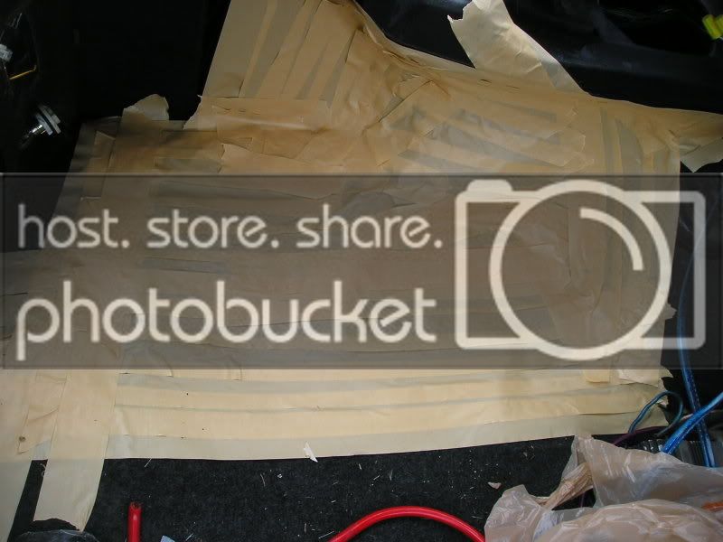

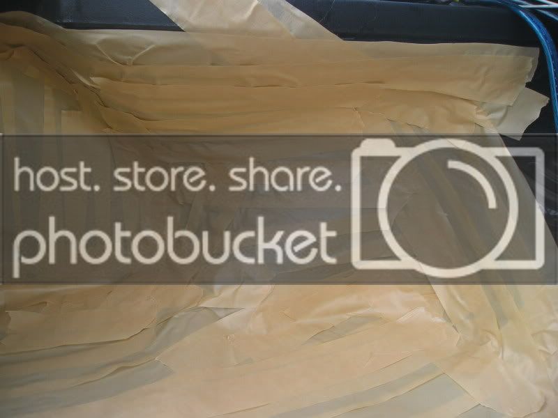

Well I re-taped the area i wanna make a mold of, and revised my design a bit... To make it easier to get to some of the car's essential panels, like for the tail lights and sidemarkers... Im going to cut it off where it goes up the wall, it also makes it easier to glass lol.
So here we go... Im going to go back over it one more time before i start with the layer of resin...
