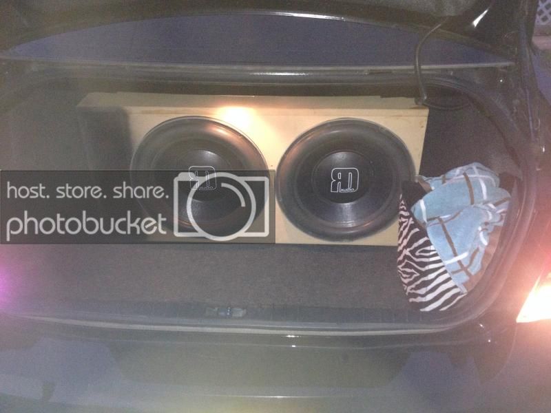

Last weekend (in a quick throw together system for a comp this weekend)I built a 4.7 cuft (after displacement) box tuned to 37hz for a pair of 15"s on 2400ish watts. It's a touch smaller than I would normally do on such low power but I was able to build the box outside and slide into a trunk:
I know space isn't an issue for you, but I'd lean a little on the smaller side with 2500 watts on a pair of 2.5" coils.
I'll have USACI outlaw TL number (Trunk 0-1000 I think) this weekend I'll be glad to share if anyone is interested.
I have always built smaller boxes in daily/SPLish builds to handle the extra power I intend on throwing in.Last weekend (in a quick throw together system for a comp this weekend)I built a 4.7 cuft (after displacement) box tuned to 37hz for a pair of 15"s on 2400ish watts. It's a touch smaller than I would normally do on such low power but I was able to build the box outside and slide into a trunk:

A very un-impressive run of 141.5 @ 39 hz which got me a second place trophy. I bet moving the box around may have helped a lot but I never did any testing. This car will have 10"s or 8"s in it before I get my own meter again.
