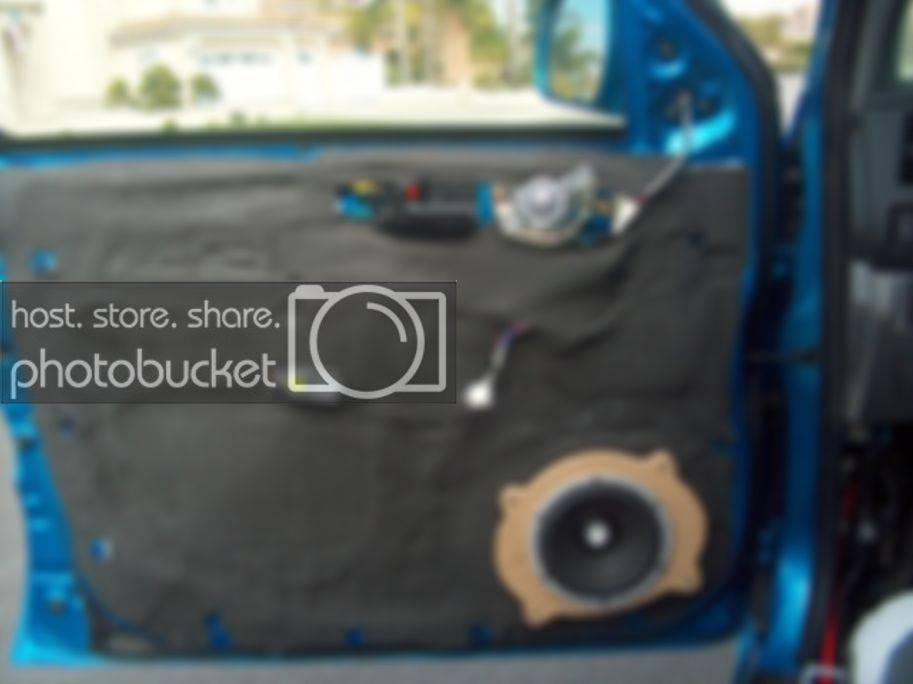

If you did as pictured, then the install should be relatively solid. I'm not overly familiar with the CTX mids....being they are an entry level offering, you may simply be expecting too much out of them. I know some people weren't happy with the midbass output of the CX mids.

Yes they are Cams pics. I just used his walk through from toyotanation and i did the same thing to my truck. I just dont have pics of my work.
Do you recommend me cutting out a pattern for a deflex pad behind my driver?
