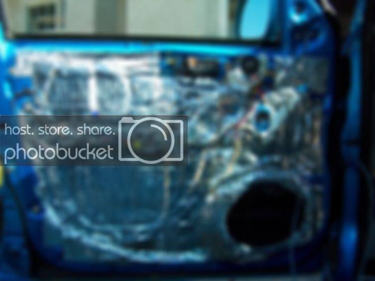

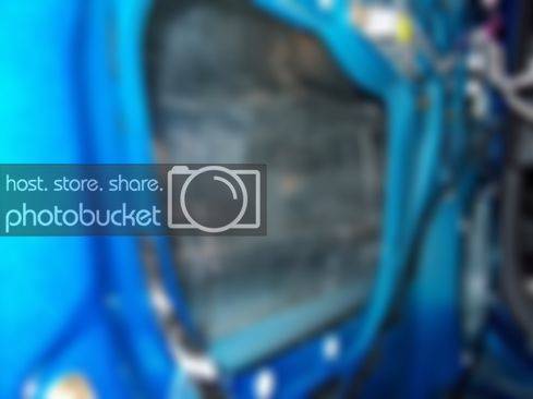

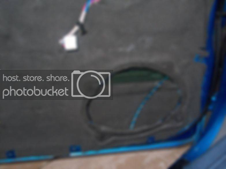

Im using Image Dynamics CTX65CS for my speakers. They're installed in an 05 Tacoma, doors are very well dynammated and i also added ensolite foam. I also have 1"mdf baffles behind the speakers. They are being powered by an Alpine PDX 4.150
this is exactly what i did in my setup....
