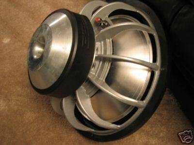

Hi guys, I just got a used 15" eclipse subwoofer off ebay. I have looked all over the interwebs trying to find specs on it. I had one about 10 years ago that I blew. I don't remember the watts. I can only find info on the Titanium and i think i have the aluminum. Anyone able to help find the specs on this sub? There is also no marking on the sub anywhere except to say "eclipse"
Does it look like this? If so, there will be a sticker on the side of the magnet stack, or on the back side of the cone (look down the pole vent). Should be the SW8152DVC or 88150DVC.

Edit: no ti basket.. //content.invisioncic.com/y282845/emoticons/banghead.gif.8606515f668c74f6de0281deb475b6fd.gif
