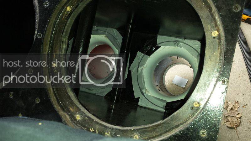

Also tape up aero flanges if you have them. Gained .3 taping my four 4" aeros on my old re mt 18. Here is my current box, redid the flange tape with gorilla tape, seems to be thicker and stronger than regular 3m.
