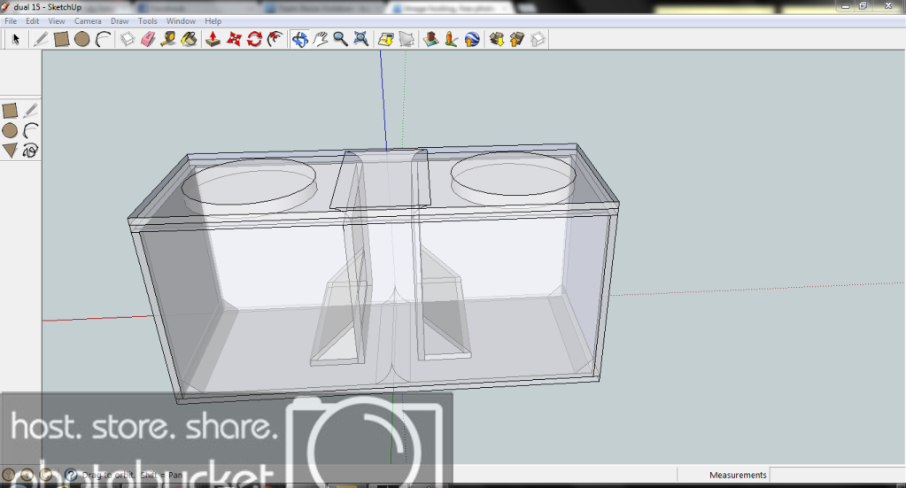

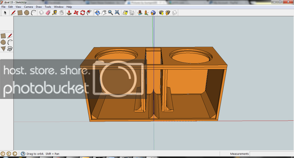

dual 15s
how do I get rid of the planes on the port opening and sub cutouts so I can see inside the box without the plane being there??
It's better to choke a sub on airspace than it is to choke the port. Choking the port will create a very uneven frequency response as you add power as the port will be unable to move any more air at or near tuning. No point in tuning low if you dont' have enough port area to actually move air at those frequencies. Low airspace does reduce tuning peaks some, but if your subs have alot of powerhandling, you can somewhat overcome this inherent effeciency disadvantage.. I'd say Anton is right on this one, generally speaking.
