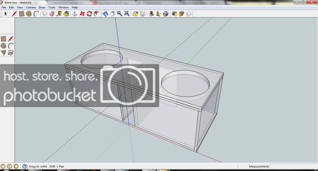

gonna go with 2 15s so I can get the 150 that im looking for... heres the design. 3.42 cu ft per chamber before adding bracing, will work out to a little over 3 cu ft per chamber after bracing, 90 sq inches of port tuned to 33hz. comments please.
i think im getting much better at designing...
---------- Post added at 05:55 PM ---------- Previous post was at 05:54 PM ----------
45s will be added as well.
i think I may go subs up port up... no kerfed ports, 45s and roundovers will be added, just too lazy to draw them. this is a rough design anyways being that I dont even have the woofers built/tested yet...
Whats the port going to load off of in your truck?
im going subs and port up, loading off of the roof.

don't do port forward....either both firing up or subs forward/port up. Common chamber also, no 45's

db drag, but the local shows do it meca style. and why should I go with a single shared chamber??
I've always done them like that and had good luck, look at everyone elses boxes and they are always shared chambers. It's just that you don't see seperate chambers I guess, they don't work as well
