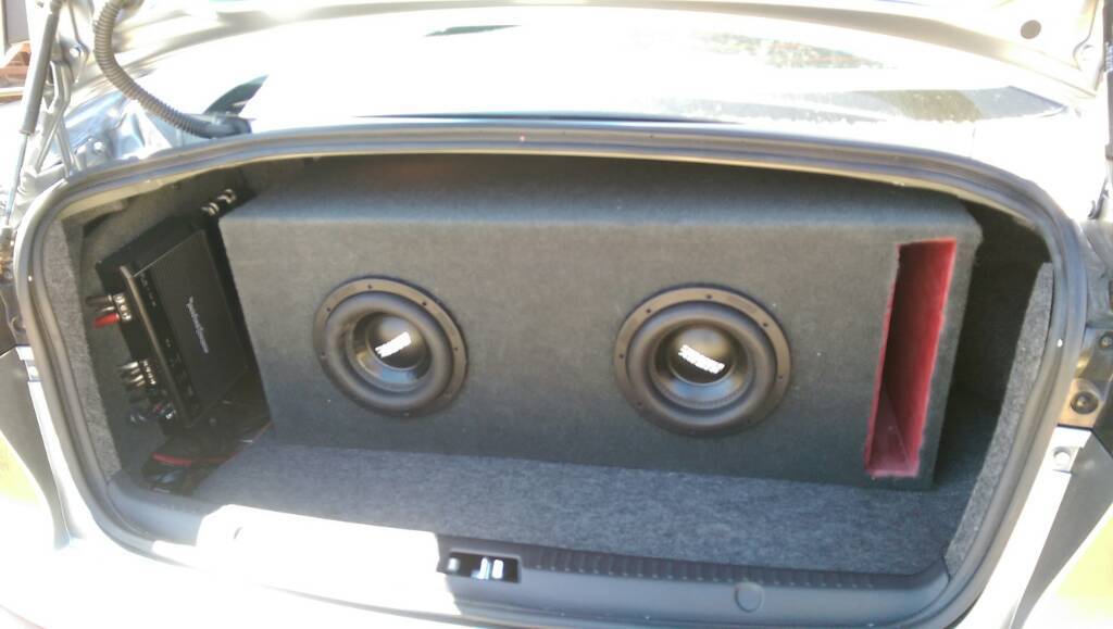

I have two 8s in my trunk and I could not fathom two 15s in there. It's an evo. Eventually I might go up to a single 12 or 15 but that'd be down the line some time. I'm interested in what you end up doing!
I've since built a new floor and added another amp under the floor. That box don't wiggle one bit and you should see me do the "I'm gonna squeeze this fat ***** in the trunk" dance.
