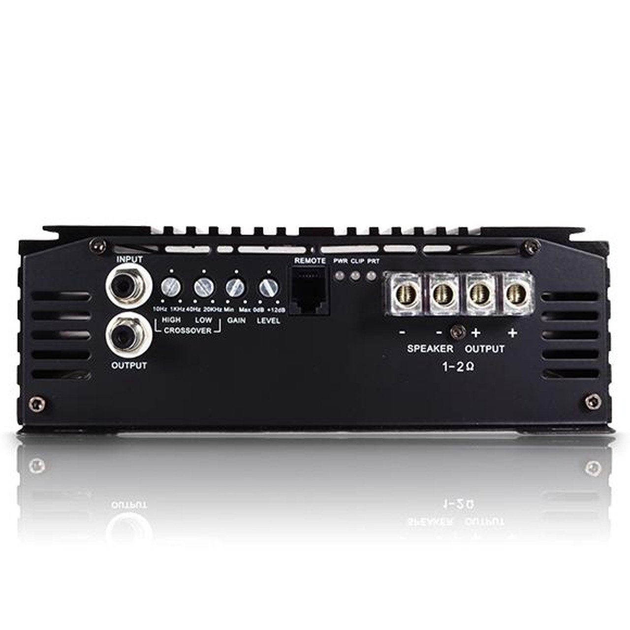

More mono amps offer 2 positive and 2 negative output terminals (it looks like 2 channels but its not) then not...it's just for making it easier and give more wiring options...my mono amp has 4 terminals...I'm running a 4 ohm sub off each terminal and the amp sees a 2ohm final load...
That's a Sundown sia monoblock...
Thank you. Speaker connection. Not outputs.
Like a terminal block. Same output, easier connection for dual subs.

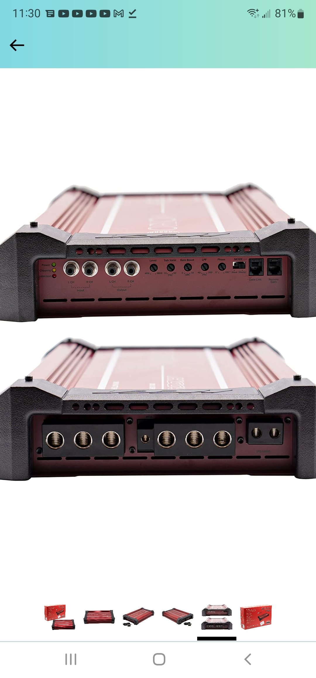

Just to jump in here in the middle of this interesting small debate... sundown over hifonics correct? Also I found this beautiful ****** orion amp for almost 800... im assuming the orion is the way to go if I can added the almost $900 for it? If not then sundown? No hifonics though correct? Lol. Also thank you guys all so much for all the help. Love this place.

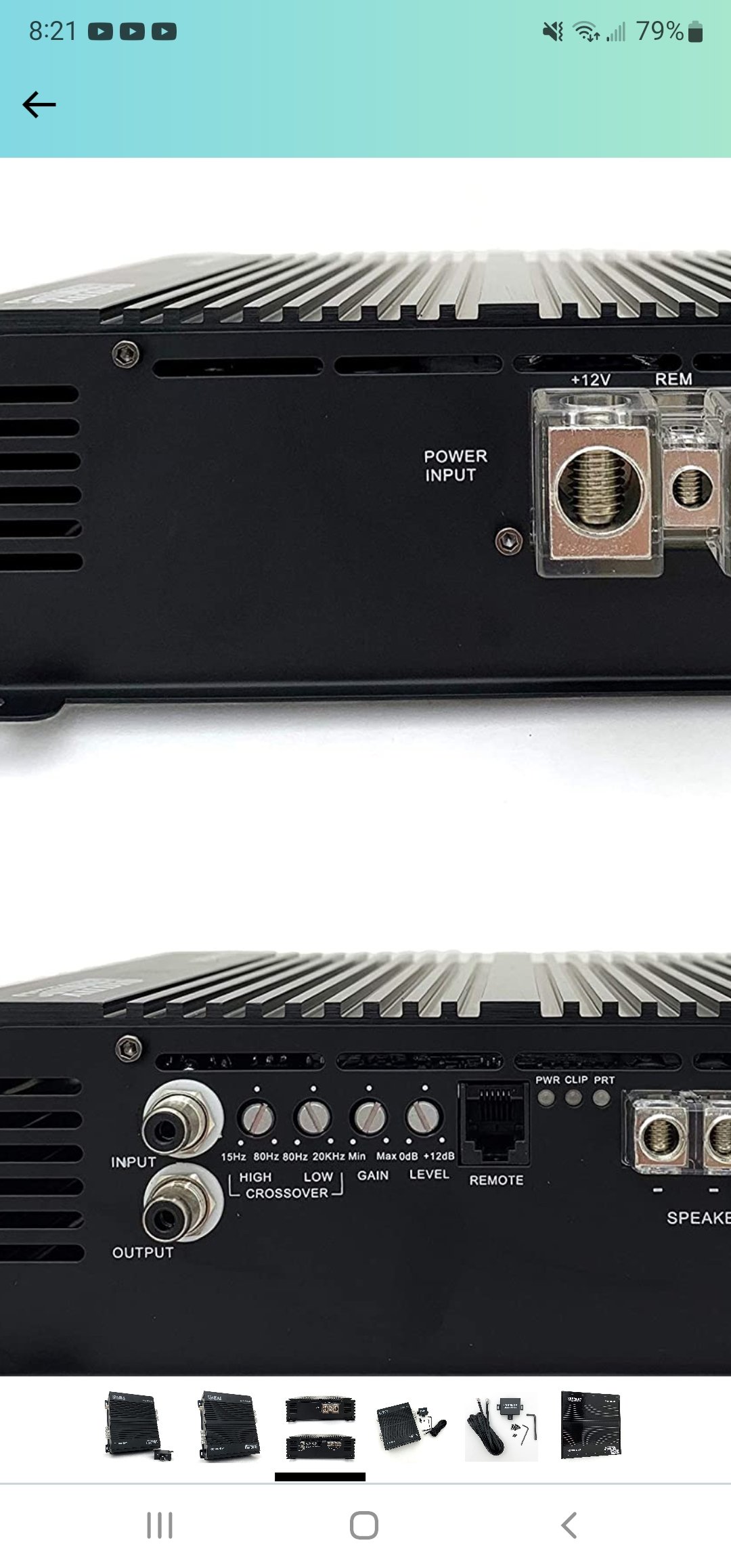

I thought I was done with the questions but here's 1 more... on this sundown amp for the rca inputs it just says input and output.. how do I know which is the left and which is the right for the rca? Input would be red and output black or white or...? I'm probably going to go with this amp and I'm just trying to figure this out awhile before waiting until I get it.
