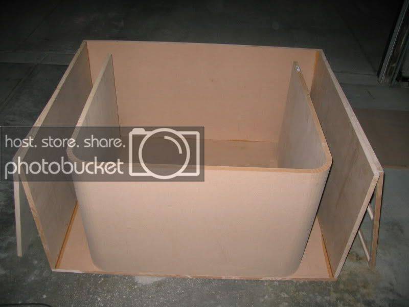

Double Flared port Enclosure build for 4 15 rockford t1's
looking at all of these custom box builds then trying one myself definately gives me a new respect for you box builders. It's much more difficult than I thought. Looks awesome man. You think you'll be able to get some vids of it pounding when finished?
thanks man. i should be able to get some vids.
answered the question above.
Ahh, I assumed you were gonna be fiberglassing the kerfed part's.
So is glue all that will be holding the kerfed part's, or will they be pinned / screwed as well? Sorry for the noob questions, But like i said im interested in building a box like this for my sisters Blazer Xtreme. Only to a MUCH smaller caliber.

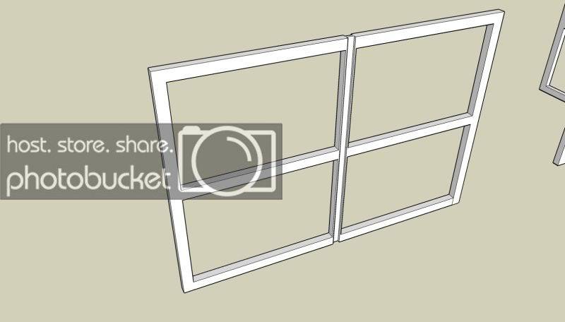

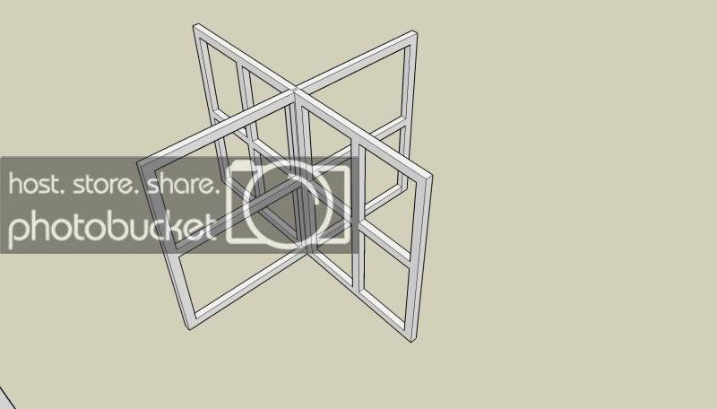

anyway hers some new pics... i drew up the bracing exactly how its gonna be, except that it will all be rounded over...

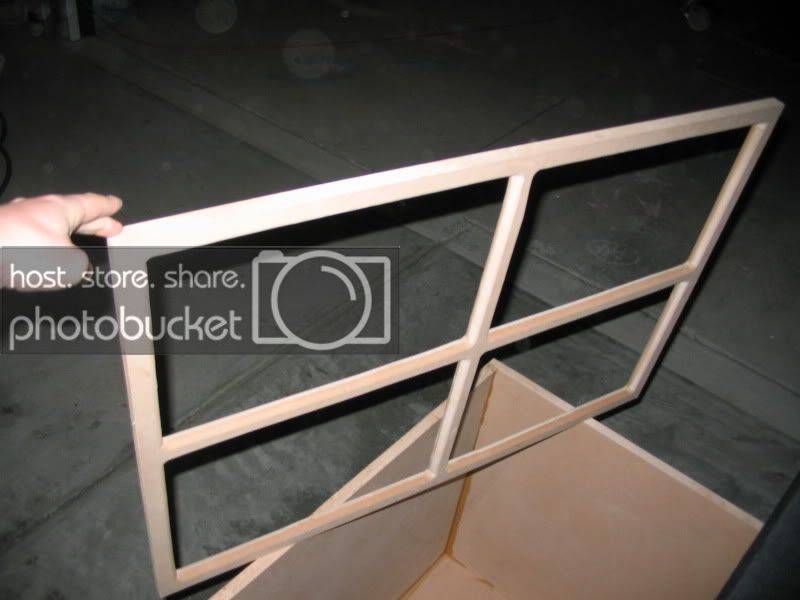

heres the brace that goes across the width of the box...
heres the whole thing..

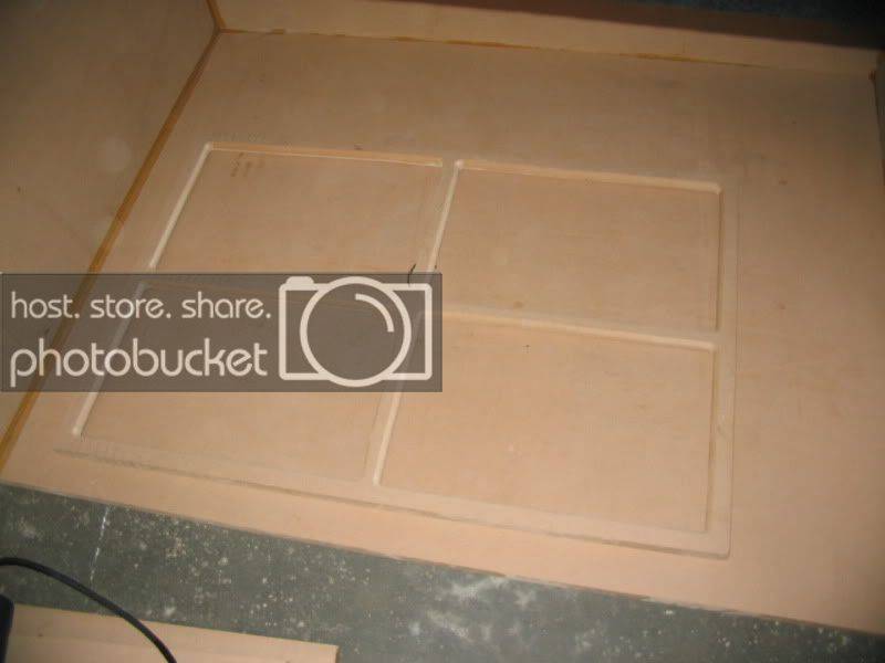

you should router 3/4in grooves in the mdf for the bracing to slide/lock into not only does this make the strength way better but it will make assemebly a snap //content.invisioncic.com/y282845/emoticons/smile.gif.1ebc41e1811405b213edfc4622c41e27.gif
look at the pics...

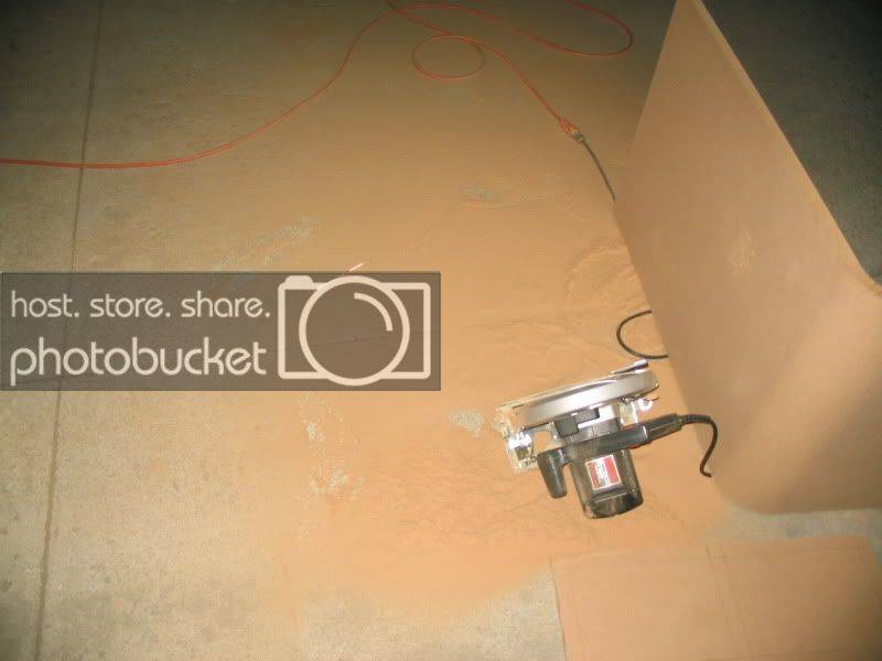

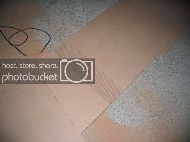

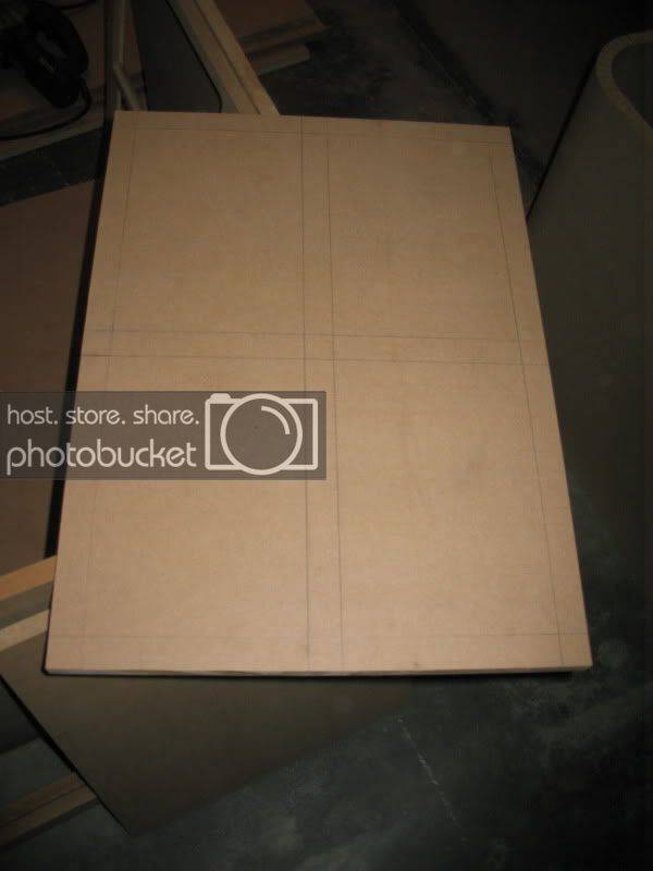

more pics... the kerf took FOREVER to cut because i had to use my circular saw and had to move the fence every time //content.invisioncic.com/y282845/emoticons/verymad.gif.3f39c5c2fd57527b671fad3efdfac756.gif anyways heres the pics...

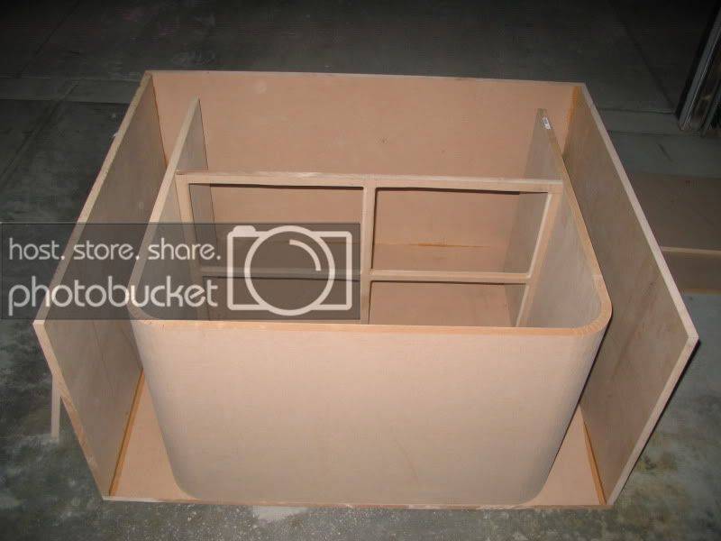

the other brace mocked up
fvckin mess:crap:
brace mocked up
