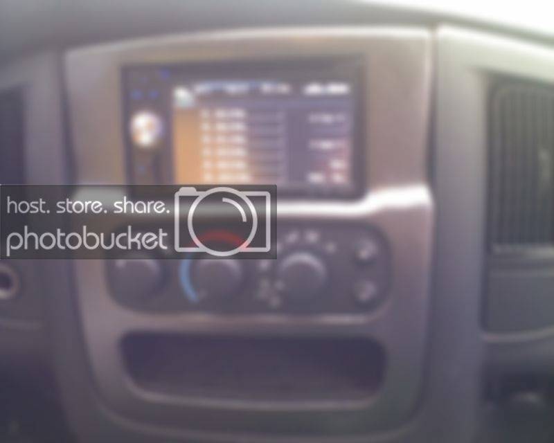

ive done it on a ram, same dash bezel however

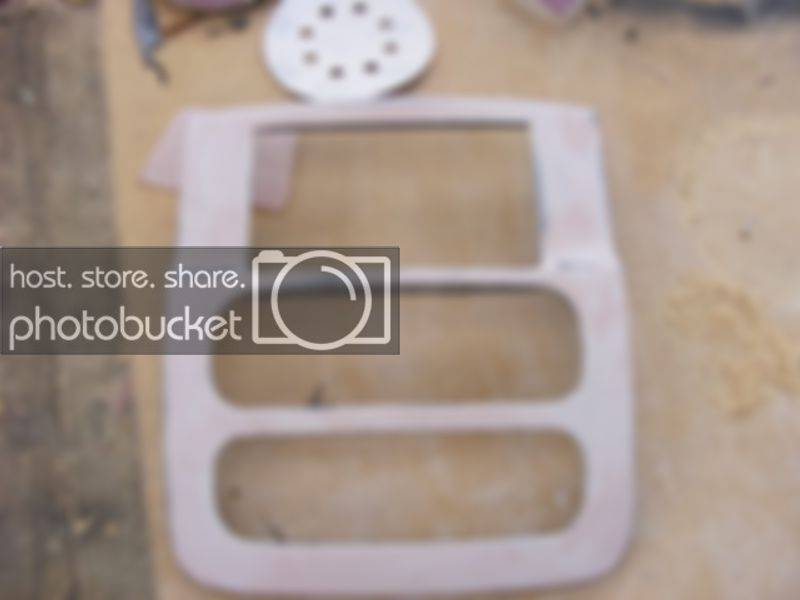

Its a similar bezel, but mine is the entire front panel like the pic below. I would just have to enlarge the size of the upper opening, but I dont know how I would deal with removing mounting brackets and adding custom ones for support.

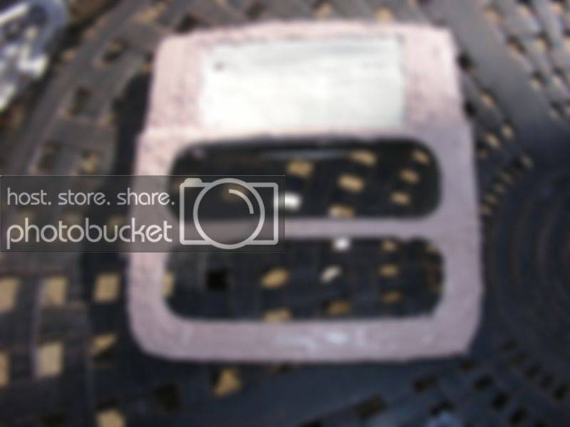

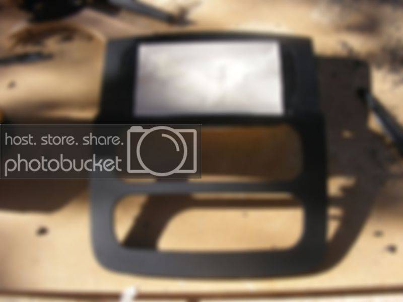

This one was attached to a larger piece like yours as well i just removed it.
As far as the brackets the way i did it had iso mount brackets built onto the new dash piece.
